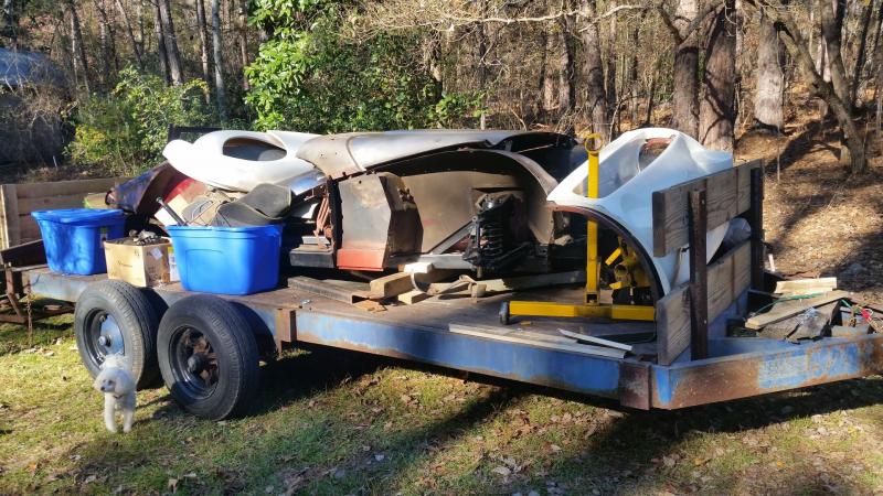

TR on trailer 2015.jpgHello All
I am David from Macon Georgia.
This is not my first TR. I drove a 1955 TR2 in 1968. That one got totaled in a rear end crash.(I was rear ended) I got another TR2 a 1956 or 7 and drove that to 1974. I kept the totaled car for parts and the rebuilt motor. It finally went to be scrapped. Oh for a time machine. The car was crushed with a full set of gauges and some other useable parts.
About 6 years ago I was put in contact with someone who had taken a TR3A apart in the late 1990s to do a frame off rebuild. He got it all apart and did a bit of restoration work but then seemed to quit working on it.
There are a lot of random parts that he bought from the Roadster Factory in 2000.
His son finally decided to let it go last October and I drove to North Carolina to collect the car. I had only seen photos so I was a bit unsure what I was getting.
Overall I think that I have a very sound car to work on with a few body work areas that I will have to re work. When I got home with the car I was looking it over, the body was sitting on the frame so I tried to fit the doors. The passenger side fits kind of ok but the driver side will not fit in the gap. The "A" and "B" post are too close together. The PO had replaced the floor panels, sills and rocker panels. When I get to that stage looks like I will need to do a bit of un welding and resize the door gap. Along with some other rework. I do not want to start out with fiberglass in the body work. I notice some fiberglass between the new floor and the side panels.

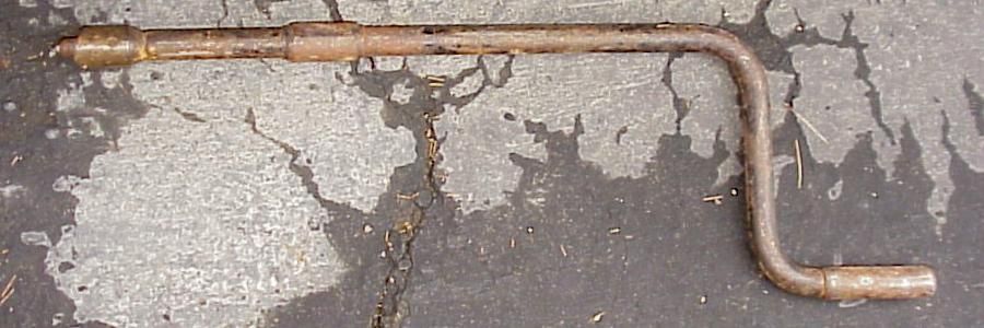

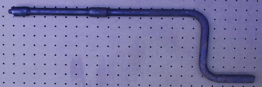

Note that the hand crank is different for the later cars; be sure you get the right one. Ebay sellers often pretend they don't know one car from another. (My favorite is still the seller who promised that the disc brake rotors he was selling would fit my TR2.)

Hopefully someone else can provide more info on the hand cranks; I just know there are at least two and probably 3 variations. Ironically, in 40+ years of TR ownership, I've never had a working hand crank :)
Here's a couple of photos that were posted by Geo Hahn at one time or another
crank-long%20-%20Geo%20Hahn.jpg~original
crank-short%20-%20Geo%20Hahn.jpg~original
