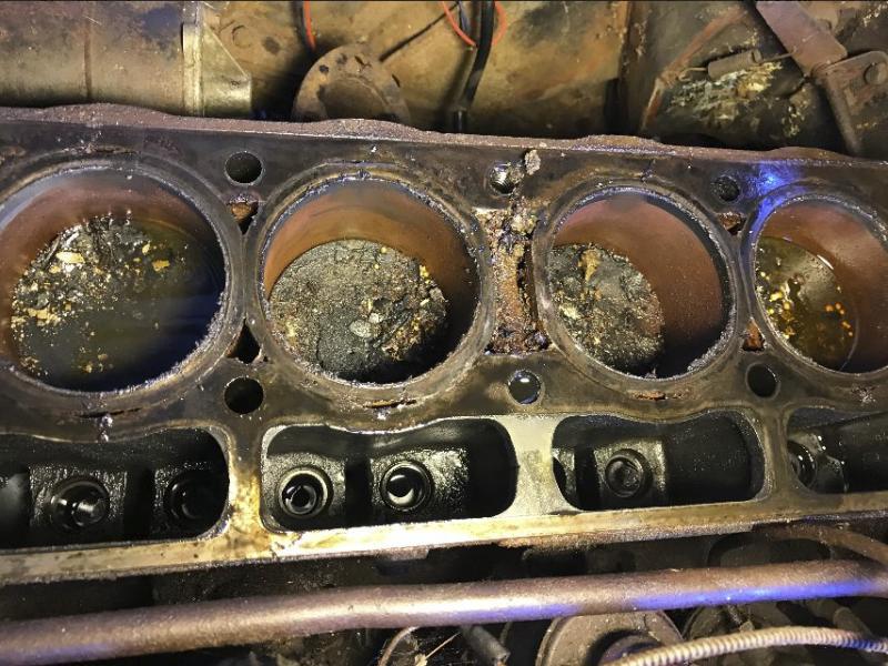

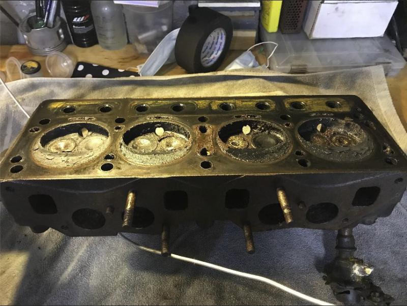

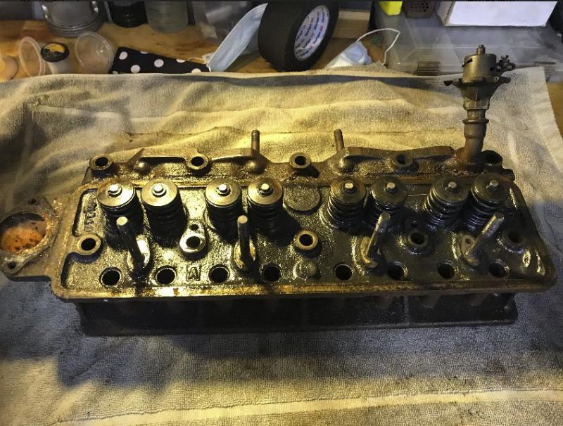

The head you show is a TR4 head. Pretty much the same as a TR3. Good luck.

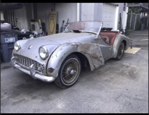

Hmmm...I could be wrong, but it looks like you might need a new left front fender...
That head, if not cracked, is gold. I recently rebuilt an engine in similar condition. It was seized, needed a new piston and cylinder set, but the internals were pretty good, much better than you might expect from external indications.
How is the rust situation in the body and frame?
You noticed right! Previous owner had the drivers front wheel stuff itself into the fender when it came loose from the spline adaptor.
BUT I have 2 new rust free front wings coming to me. The car is rusty, but not horribly corroded, the floors could be patched, the trunk has a hole in the left front corner (Could probably be patched as well, tub corners are rotted but not that bad, Frame is solid! Just hope it's not bent from the "Loose wheel" incident

Good to know about the head, I'll have it reconditioned, and I have a set of carbs from a TR4 ready for rebuild. Motor comes out next and I'll have a look at the crank and stuff.

You defiantly got a bargain with the price, not many freebie's around these days? I think the only thing TR4 about the head is the heater tap which is a good upgrade if you want to turn the water off and on from the cockpit. It looks to be all there so have fun.
