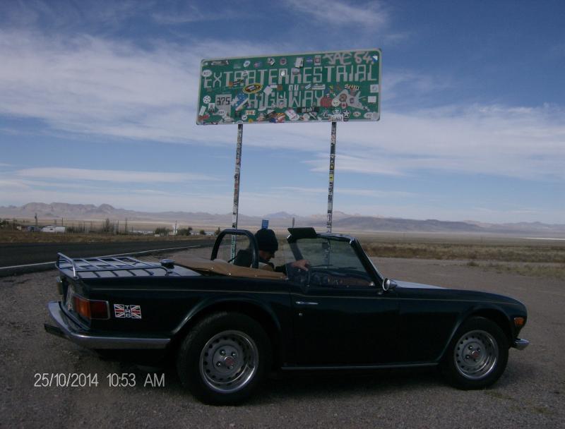

Sounds like the same SAND DAM I did on my TR 6. This summer locked in at home started with new radiator and geared starter fuel filter Ho timing chain cover leaking so seal & chain. poor windscreen so new glass. Overdrive leak OK pull trans new gear on flywheel for starter, all seal on trans . carpet 27 years old so new and removed role bar. Removed soft top for Backlight ready to install shipped from UK broken so on holding. I built the car from frame up 27 years ago so it was an old car again. Seats and paint still great so my baby like new again. Madflyer see old picHPIM2684.jpg
