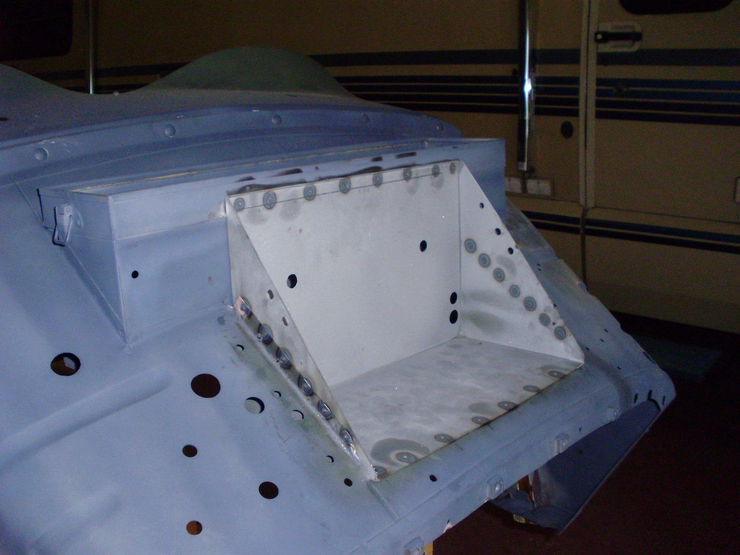

I have a 220-volt model and it does a fantastic job! Installing a new battery box using the original spot weld positions. Yes, they are pretty heavy! PJ
