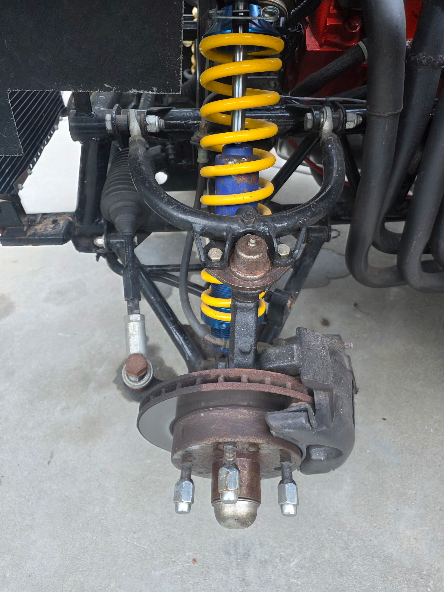

thanks darth, poking around further i find the front uprights have ball joint uppers and lowers - no trunnions. the steering arms are part of the upright. my memory sez both TR6 and Spit had lower trunnions and separate steering arms... maybe when i pull the wheel off tomorrow, getting a closer look + caliper inspection _might_ offer up some clues...

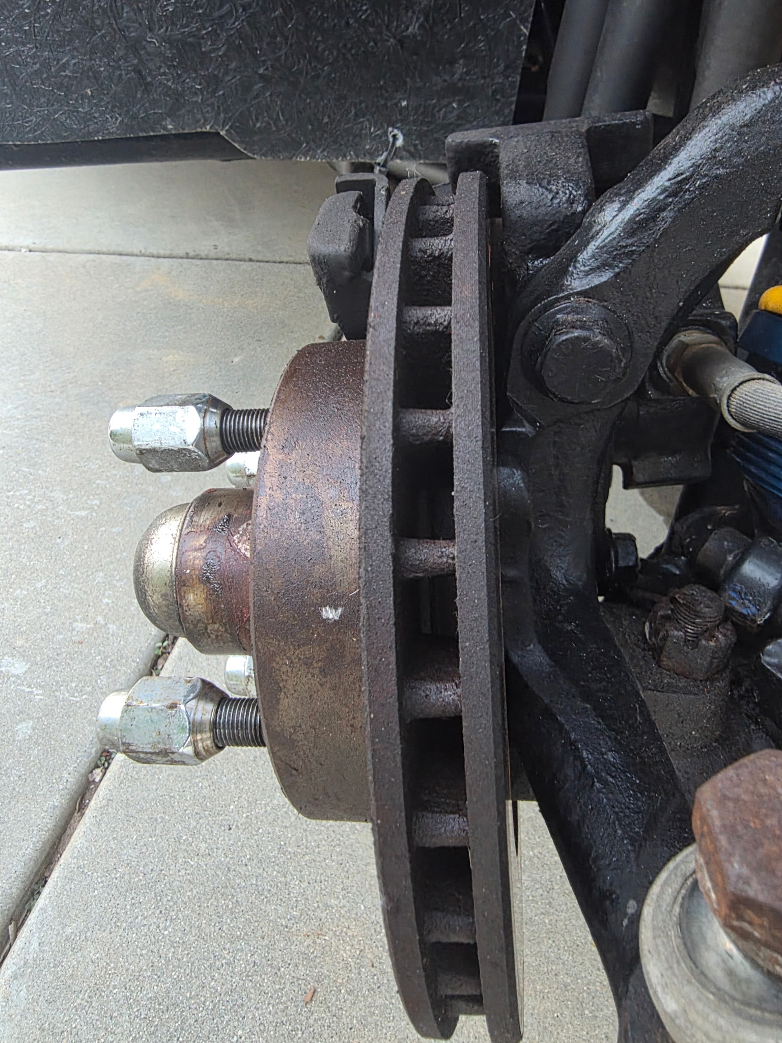

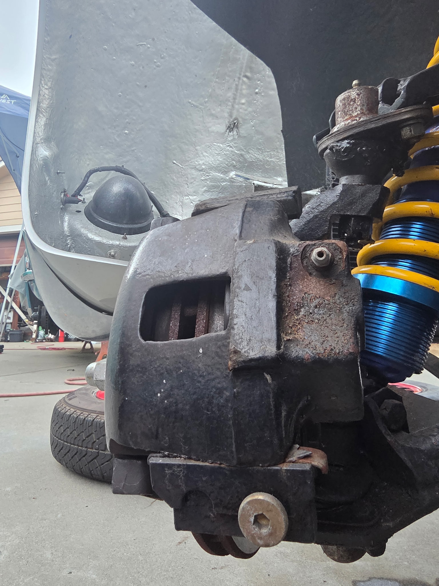

so, it looks like Ford front calipers and rotors on a maybe a Ford upright?? and Afco coilovers... grateful for any thoughts as i do not recognize any of these components other than Afco - who I also use...
Factory upper wishbone modified to suit ball joint.
Agree they look like a Ford component. Don’t know why they change everything, as factory set up works fine if maintained.
That’s going to get warm with the exhaust ruining like that.
Dumb previous owner using 'racy' parts unsuitable for extended use on a street car - I'd remove the heims and replace with conventional tie rod ends, but a warning - check to see if the steering arms have been drilled out to a parallel hole instead of a tapered one that takes a stock tie rod end. If that is the case you'll have to buy new steering arms - which are likely NLA so you'll need to source good used ones.
thanks billspohn, i am aware that the steering arms are likely drilled straight thru. unfortunately the steering arms are part of the uprights so... i am not a huge fan of heims on the street. lack of "give" tends to transfer into the frame and leads to things cracking/breaking... Ford branded single piston sliding caliper using a vented rotor on a ball jointed upright using a Nissan master cylinder... Pinto maybe... have to dig at some point just so i know, but most of my life spent in Brit rides so little Big Three knowledge.

On the tie rod ends, I have run drilled arms and Heims on the track but wouldn't like to on the street. What front suspension does your car have? I thought they were Triumph, but they had separate steering arms - yours certainly are unitary design.
no clue as to what the front susp is... yes, should be TR6. but isn't. i have pics of the "restoration" and i can see original susp then l8r on, what is there now. so i know it isn't some oddball ex race car.
