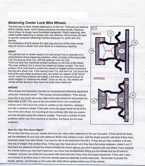

But I think you'll have a much harder time finding some place that has the proper equipment to balance wire wheels. It has to grip the wheel by the normal cone surfaces, not just the opening, or it won't get the wheel properly balanced. Probably worthwhile finding a place that specializes in British wires.

Getting them balanced PROPERLY can be a challenge.
