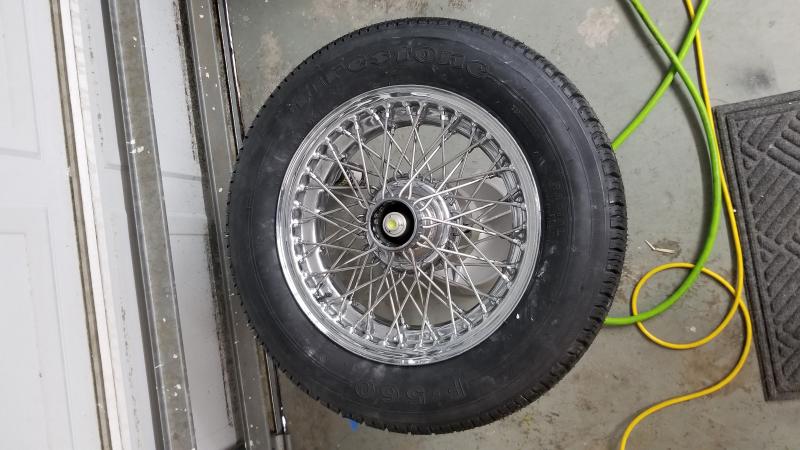

I received the tires yesterday and got them installed. It was actually much easier than i thought it would be. I have always changed my motorcycle tires and usually have to curse and fight them on, not so with these tires.
I used a bead breaker from Harbor Freight, tire irons/spoons, tire mounting lube & paste and used a tire balancer from Harbor Freight.
Was it worth the $100 I saved doing it myself? Probably not but I have never changed a car tire and like the challenge and satisfaction of doing it. Hopefully I won't have to mess with them again for a long time and change them because of mileage not time next time.

Nice work. Did you put talc on the tubes?
Yes I used powder on the tubes and used rim protectors while using the tire irons. My father in law owned a tire shop and recommend after inflating deflate it again so everything adjusts in place properly.
Thanks for sharing your experience with the tire and tube change-out. Glad everything worked out for you and the solution was somewhat inexpensive.
I'm curious about the DIY approach and been tempted to purchase HF's aluminum tire levers just in case. Was any modification needed for the wheel balancer to work on center lock hubs? Any tips you would like to share? GONZO
Some tricks I found with the HF wheel (bubble) balancing and HF tire unit. Because the wire wheel won't center, I put a PVC pipe end cap in the hub to take up the space and center the wheel. On the tire remover, I mounted an old wire wheel hub that I had to hold the wheel as the "pins" are made to fit the lug holes. Watch for sales or 20% off coupons. This works well for me as I tend to break spokes often.
What is used to protect the rim?
I slide old bicycle tubes over the tire irons to protect the rims. Never a scratch or marred spot.
