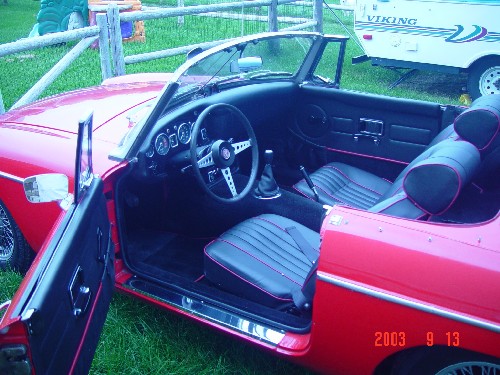

I also reskinned my originals with leather from Prestige. I also got new foams and webbing. They turned out very nice and comfortable. I will attach a pix.

I went through the effort of getting new foams and seat covers for the seats in my '77 B. The instructions that came with the seat coves were very straight forward and once I got the hang of it, it was actually a simple operation. Did the work on my seats solo. Then rebuilt two more sets of seats for others in the car club. Went much quicker with an assistant.
