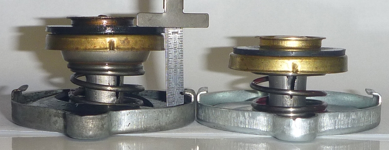

This is the 1st time it has ever done this and coincides with a new Radiator cap I put on it when I did the trunk. I removed the new cap and compared to the old one and it is about 1/4" -1/2" shorter than the old cap. I'm assuming that the cap did not seal, causing a lack of pressure with water bypassing the cap to the point where the water level was lowered and it got really agitated, causing the foam. No oil in the water from what I can tell.
Are there different size neck lengths for Healey radiator caps? If so, where can I find one. The one from Moss must be a short version.
Your assumption is correct.
I suggest you go to David Knock @ British Car Specialist for the correct item for your car.
Jay Leno did the same thing in his Daimler SP250 video on line. He had an American cap on the radiator that was too short.

Moss sells two 7 lb caps - 3/4" and 1" reach. You want the 1". Here they are:
