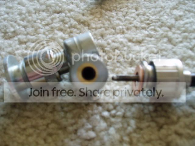

Okay. So I have verified that all threads are correct, so I put it into
a vice and screwed the thing together. Very simple, with a little bit of
force (something I try to avoid).
So, I have pictures of the way I think this thing should be going
together. Problem is: It does not turn the cable, one end to/or the
other, as it should.
A shot of one end of the speedo angle might suggest to me that something
could be missing from the insides of the speedo angle. The black hole
is like way larger than the cable end that goes into it. Seems something
should be in there to engage the end of the cable:
And this shot shows how I think the pieces should go together, but still
verifying this with Quantumechanics.
WOAH!! The gear and drive "dog" ain't there, man!! It should have a square "receiver" end in there.
HOLY TOLEDO! We've hit on it. The darned insides of the speedo angle
seem to be flat out missing!
First, I'm bummed cause the part ain't right;
Second: I'm delighted to find the problem.

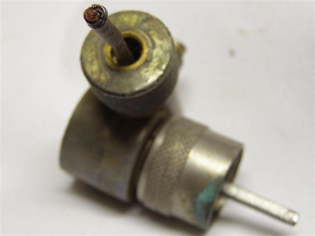

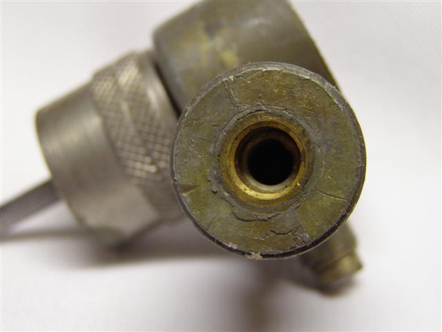

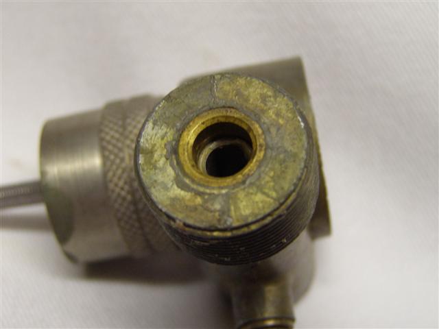

Here's a few shots that I got. The turning one cable, turns the other. The "square" female hole is down inside the end of the adapter.
Dennis, are you pushing the exposed end of the cable (speedo end) in as far as you can before trying to spin the angle drive?
I.O.W. the inner cable needs to be "bottomed" in the angle drive to see if it will spin when the drive is turned. That last shot Paul posted is of a snapped off cable end. it's deep enuff into the drive that it would turn as the trans side is rotated.
