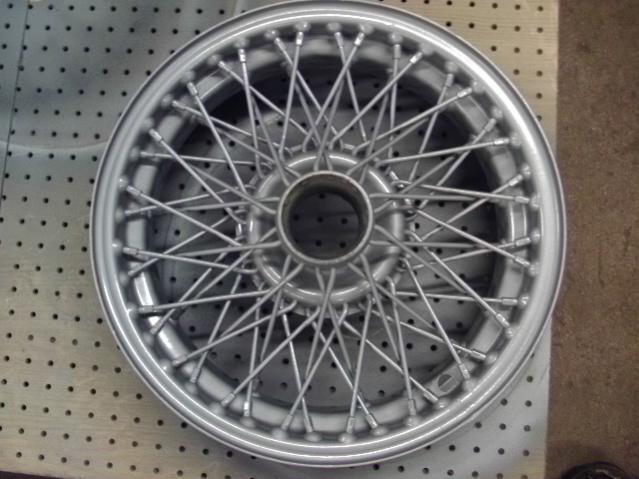

What I use is Ford code M5967A. It's I believe from 2000 and called Silver Poly. I get it from CARQUEST in their Omni line of acrylic enamel and use a hardener in it. After sandblasting the wheels I spray a coat of epoxy primer and a couple hours later spray the color. Contrary to what many people believe the wheels are supposed to be glossy and not a matte finish. I can't figure out how to post pictures on here but if you would like to see pictures of some 60 spoke wheels I painted last night PM me and I'll email them to you.

I think I figured it out.

Thanx BRSLimited
Wheel looks like new. I'll check out our local CARQUEST and see if it's carried here in Canada.
