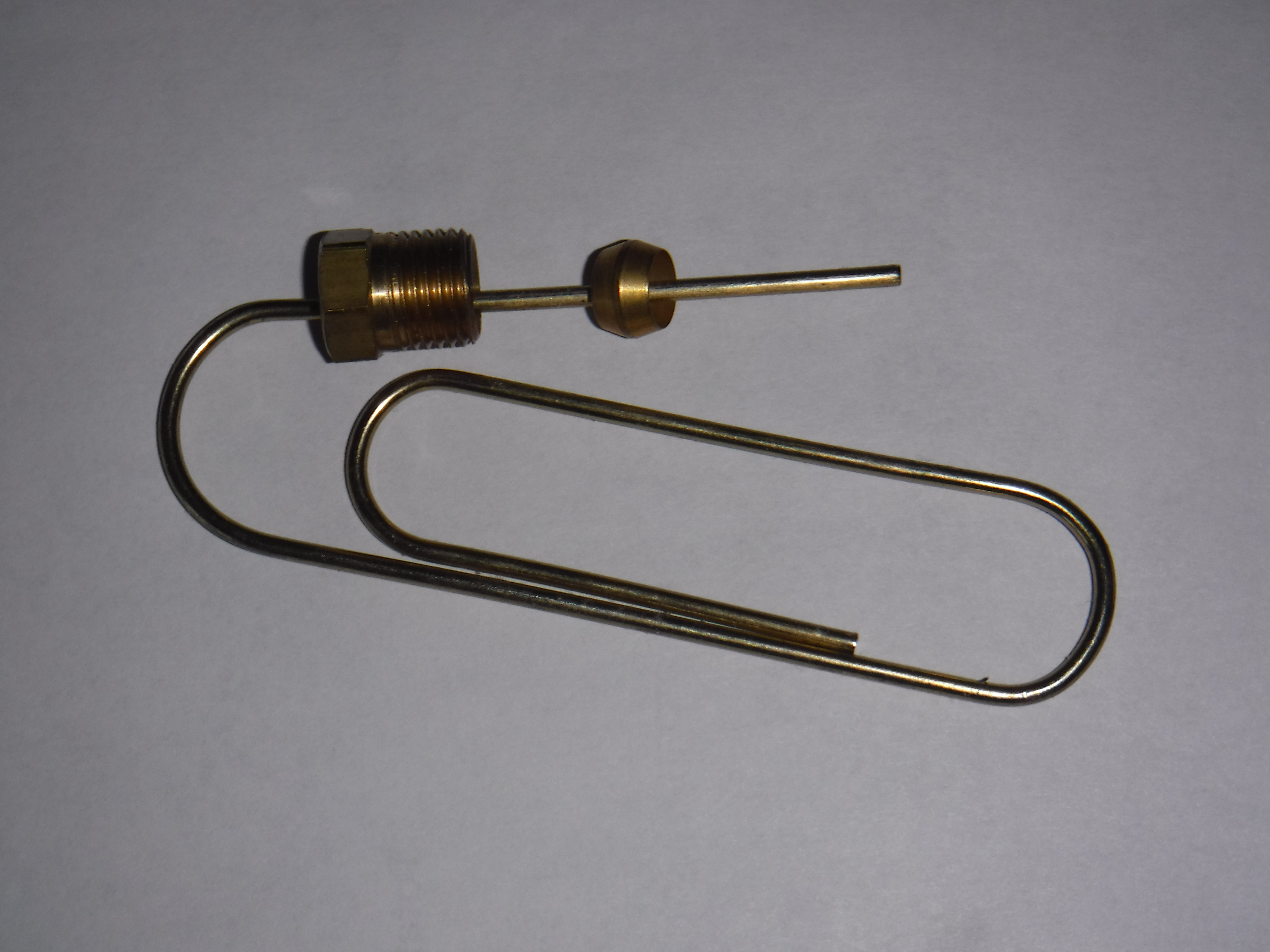

Say again about the fuel pump. was it OEM with the lever primer? and was it the fittings to body. I have fix others who had line fittings that bottomed out, they need to seal in fuel pump with out the fitting head to hit pump body. Roadster Factory sells the longer fitting ( part # 60142 )
