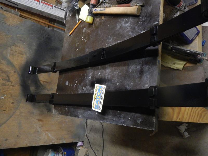

On my springs I decided to go with the ones made by Eaton springs. They were not cheap but as I had not got my front spring mounting points out of the frame I wanted springs that would outlast me.
I contacted Mike Eaton and he assured me he could make springs to match the drawings in the TR hand book.
They looked very good but because the material is stronger now than the material originally used they have 1 leaf less than standard but the same spring rate. Rebound clips were tight and they had the required extra spacers for the passenger side.
I had not commented on them till now because I had not driven on them but so far they feel fine. At a car show last September I was parked next to another TR3A and bouncing both cars they felt the same.
I will comment further after some more miles.
David
