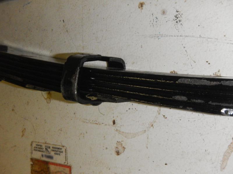

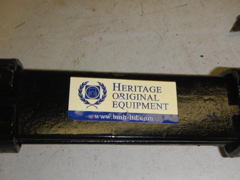

I ordered new sleaf springs from Rimmer Brothers in the UK. The exchange rate helps with the price. When they arrived I notice that the Rebound clips are not clamped down to the top of the main leaf. Exactly as described on the Moss springs several years ago.
The question was. Leave as delivered or hammer the clips down to the leaf.

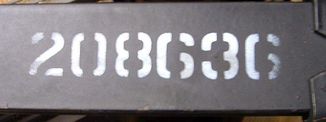

Those stenciled numbers sure do look familiar ...
208686%20cropped.jpg~original
The workshop manual is fairly emphatic about making sure the clips grip the leaves, so that is what I would do. But given all the hassle I had with the spring pictured above, I would also try to check the spring rate before doing anything else. The stock rate is supposed to be 128 lb/in; the new springs I got were almost twice that! Held the axle firmly against the frame all the time, rode like a lumber wagon and handled worse.

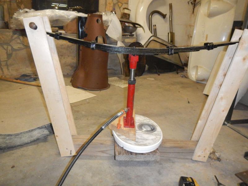

I measured 3 original springs, and got values from 110 to 145. The 145 was pretty rusty, so higher friction between the leaves likely played a role. The replacement spring came in at 222! Here's a shot of my lashup to check spring rate:
There is a second needle valve that isn't quite visible (hangs down behind one of the support bars). It and the one that is visible allow adjusting the amount of air inside the cylinder, while the gauge reads the resulting pressure. Since I know the area of the piston, I can calculate the force applied to the spring, and measure deflection with a handheld ruler (not shown). I took two sets of measurements, one with the spring rising and the other falling, and averaged them for the final calculation. Hopefully that eliminated or at least reduced the effect of friction between the leaves.

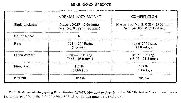

Here are the specs for the 208636 spring
TR4%20springs.jpg~original

That's what I plan to do as well. There used to be one just a few miles from me, but they are gone now and I haven't taken time to resume the search. However, I'm going to take them the drawing from the TR3 workshop manual plus the table above.

Years ago I bought a bathroom scale that goes up to 400 lbs. Originally I bought it to measure the loaded height of valve springs...but since it has proven useful for inumerable checks. If you want to get the true rate, mount the spring in a press and load it with a scale under it. Measure the weight at 1" compression, then 2" if it goes high enough. You then have the exact rate.

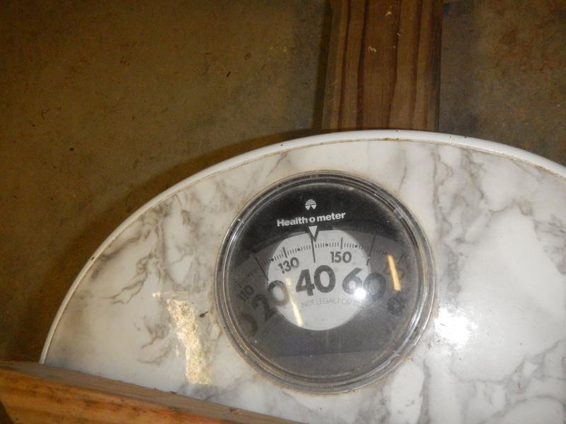

I made a crude test rig to do as John suggested so that I could measure the real spring rate.
After taking up the slack I zeroed the scale and applied pressure to the spring to get 1" of deflection. The scale read just over 140 lb. If I go to 2" deflection I get 260 lb.
Does that mean the spring rate is OK for the TR3.

Nice job of building a testing device Dave, I am impressed. You can always mail any tr3 part to me if you cannot find a home including the fiber glass stuff.
Sounds fine to me. There is only a slight difference in specification between the TR4 and TR3 springs, seems like most vendors (including TRF) sell TR4 springs for the TR3. The difference is only in ride height, all the other specs remain the same. The TR4 installed height at the spring (called camber) is supposed to be between 3/8 and 5/8; while the book allows 5/8 to 1-1/8 for the TR3. But, it's easy enough to lower by the difference, if you want to. Just add some shims (bits of old spring leaf will do) between the springs and the axle.
