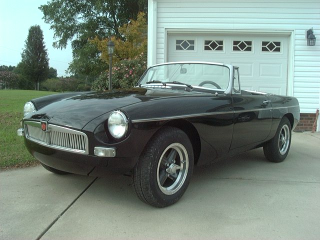

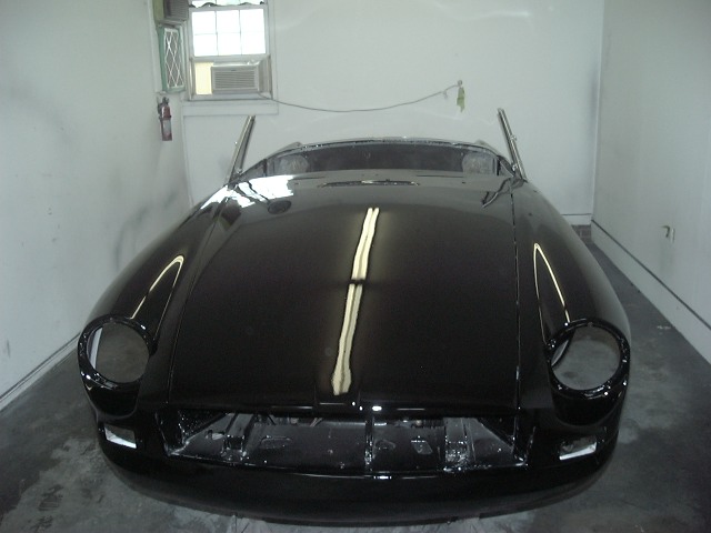

Been real busy. The LE has been on the back burner. I did get color on it. Here is a first look. More pics soon as I start back on this little project. Bob

Still slugging away at this one. It drives at least as far as the front garage! Bob

Lookin' good, Bob! :thumbsup:
I'll say!
The "retro" fascia in that thing is grand!!!
Waay much work there.
And nicely done! :thumbsup:

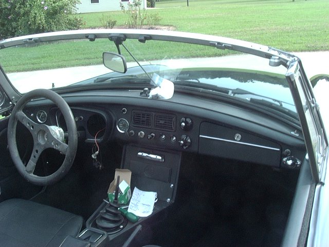

I just hope it settles down a bit. Considering it has a chrome bumper cross member and used early chrome bumper springs up front it still sits up a bit! I converted the tach over to negative ground yesterday and got the speedo in. I went with the 67 dash and complete wiring harness from a 67. If ever needed the 67 wiring diagram can be used for everything except the alternator conversion and I will include those instructions with the car. I am not a fan of mystery wiring! Bob
Hmmmmmm, I like the way those later vents look in the early steel dash, that could work for me if I ever decide to AC my GT, very interesting. What did you do to flush out the front valance with the body, spacers?
Hap, In early pics you can see square tubing purchased from Lowes. There are 2 sizes, One for the center section and smaller diameter ones for the sides. Then they needed to be pinched at the ends so it fit sorta flush. Next time we meet I can fill you in on all the things that are required to do this project. I spent several days on just the fitting and welding. Then making it fit with no fasteners showing was another trick. Grilles normally sit in from the fender edges. I brought mine even with the fenders. Then the grille plinth stuck out way past the hood. That had to be modified. It looks good now but lots of thinking went into it. Bob

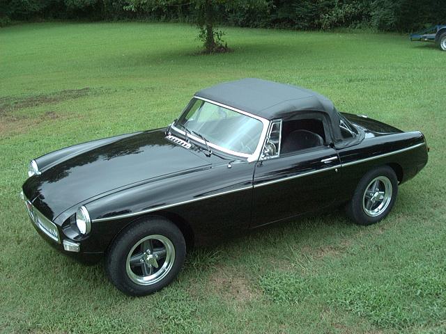

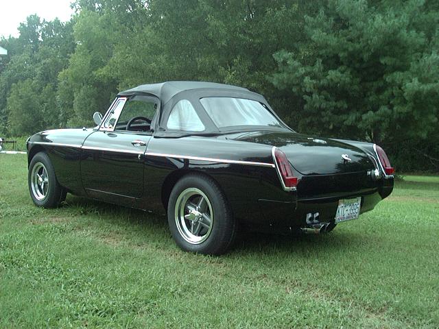

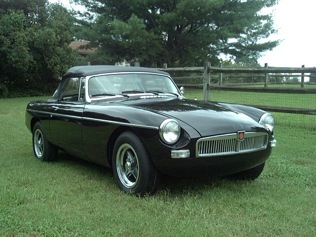

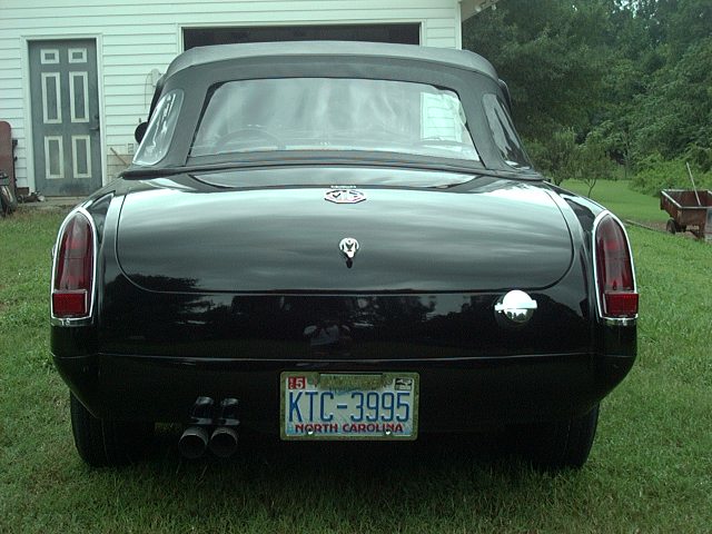

Here are some finished pics. Early next week I will buy a tag for it and start the shakedown runs. I am thinking about adding a roll bar to keep the theme of a street racer. I guess the Midget is next in line unless I find someone that wants to build it more than I do. Bob
Beauty, Bob.
Again: You're a WILD man! :wink:
Holy potatoes, Bob!! Man, do you do AMAZING work! What an inspiration!
Have you ever thought of publishing a How-To book about MGBs? What you know and have done would benefit a great number of MGB enthusiasts.
