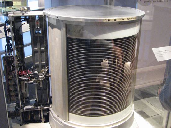

Speaking of hard drives - the 1956 IBM RAMAC's hard drive. Held a big ol' whopping 5 meg!
Platters the size of pizza pans. But it worked.
