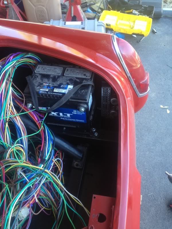

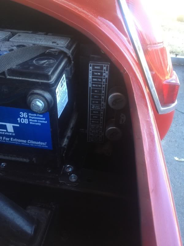

Not much to report today... spent most of the day working on the Camaro. got the wiring harness mounted in the little car and I'm starting the tedious process of laying out and running wires. Good times and I haven't even gotten to the FAST XFI stuff yet. fun
Wow, that's a bunch of wires! Can't remember, you running EFI and electronic engine management?
But then, I'm used to a Bugeye which has one of the simplest post-war wiring harnesses known.
Yeah, I'm running FAST XFI with the touch screen as most of the gauges minus tach speedo and fuel, which are speedhut supplied. Most of the wires in this harness wont be needed although it's a pain since the block is mounted in the back of the car and the wires I need short are long and the long ones are too short... easy fix as I'll be cutting and soldering anyways, just more work. I'll have to extend the fast xfi harnesses and the touch screen harness but it'll be worth it in the end. Added to the old school sprite wiring besides the fuel injection and gauges are a compact radio, push button start and a lot of other hard to start type things

Having nothing to start with but a few plugs is both a blessing and a curse. Spent the morning figuring out that the top bulb in the rear is turn signal, red wire is parking lights and the other wire is brakes. After not wiring a complete car in a long time it's easy to get frustrated laying wires out and getting after it, especially since I'm taking a break right now having, not paying attention, spliced the left taillight wire into both sides of the car like an idiot... easy fix, just wasn't paying attention. The real issue is I'm far too sober to be wiring.
Got alot done, really it's not too bad because there isn't crap for needed wiring in the car, no power windows, no ac/heat, no power door locks, no dome light, most of the gauges are done with the touch screen, the other 3 are easy day. I may have the wiring all wrapped up tomorrow as far as everything but the front end that is.

I was going to run the engine controllers in the back of the vehicle but I got a wild hair up my butt and checked fitment behind the dash area and they literally fit like they were made to go there!!!! All wires will get hidden behind the dash/console area this way and I don't have to cut or solder a ton on the harness to lengthen it. I was going to hook the harness up to figure out where to fun the hole through the firewall but it's too **** cold out there!!!!
