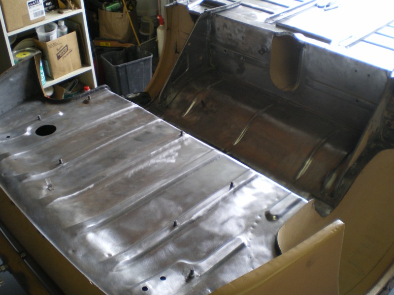

I did the same thing with my body guy to correct some issues with the trunk floor. The car was upside down and I was the one inside. Worked out well...

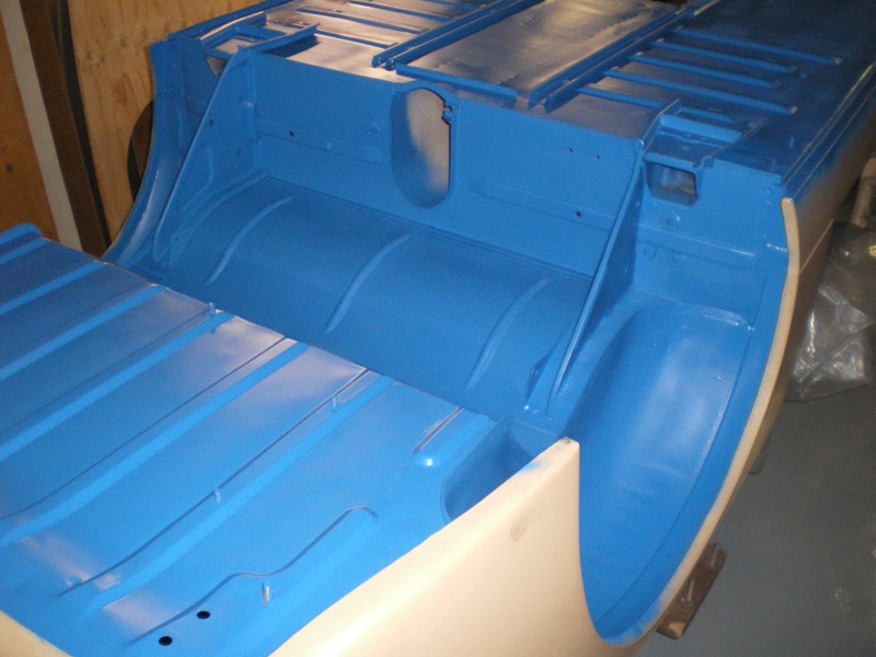

...with rust barrier primer...
