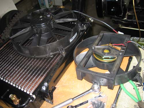

Well, I just ripped off the front apron from the TR3. Nice when all the bolts are new with never seize on them. I took my time and it was off in about an hour and a half.
I have to change the fan, because the one that was supplied with the rack and pinion kit is just too small for the job. It's a 10" fan that can't keep things cool if the outside temps climb much above 85 deg F. I got a 12" Spal that moves 1630 cfm. It'll be a tight fit behind the radiator, but I need a bigger fan as I don't have any engine fan, the motor has a few more horsies then stock.
Will keep you guys posted. Should be done by the end of the weekend.

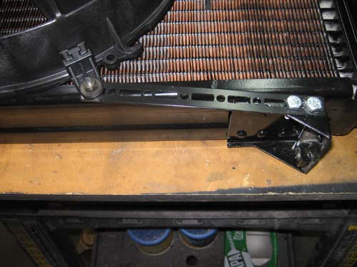

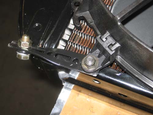

OK, the fan is mounted on the radiator. I had to move it up as far as possible so the fan motor would clear the frame cross brace. The mounting kit worked out really good. Much better then those plastic nails going through the radiator like the previous fan had.
Oh, and thanks to Don Elliott for his suggestion of slotting the radiator hold down screws. It made it a breeze to get those screws in there. I used a large set of forceps to get the screw in position, pushed up with with my finger, unlocked the forceps and with a screwdriver, ran the bolts into position. All of this done topside from the front. I also tapered the ends of the screws to help with the lead in.
