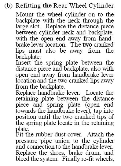

Hmm.. this could be my problem. With the 3 shims, the cylinder gets pretty tight in there. I might need to put a little more grease there too. There a trick for getting those shims out? They were a pain to get out and in. In fact, I removed the old ones by just snapping the rusted metal.

They don't need to slide easily; if you can tap the cylinder around with a (brass) hammer, then it slides "properly" IMO.
To remove the lock plates (assuming they were installed properly, many of the books show them wrong), stick a screwdriver or small wedge between the two inner plates (so the middle plate clears the tabs on the innermost plate) and then tap the middle plate out with a hammer and screwdriver. That should give enough clearance to pull the handbrake lever out, and then you can remove the inner and outer plates.
The inner and outer plates should both be installed with the open end away from the handbrake lever (meaning they are more or less trapped in place by the lever). Only the middle plate is installed the other way, with its open end towards the handbrake lever.

Also, thanks for posting the instructions on the lock plates. VERY appreciated!
