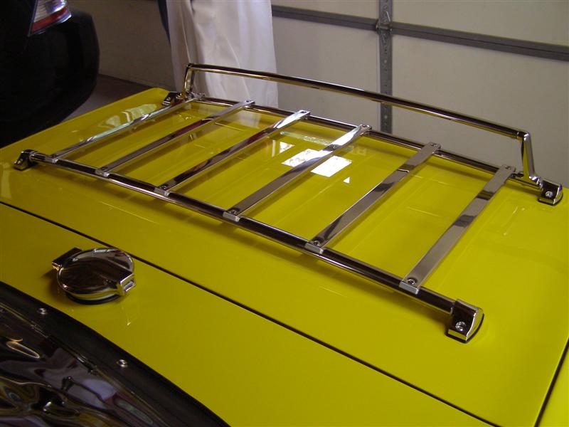

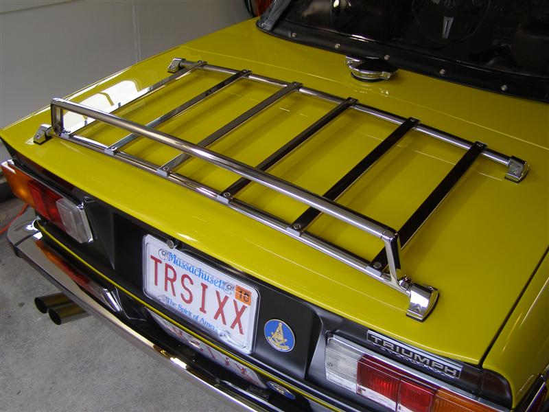

Almost home with this project. The new deck lid is on and it looks great. I just put a coat of wax on it to protect it before the rack goes on. the whole story is here including the attaching anchor options that I used in the deck lid.
Deck Lid & Luggage Rack Installation
I have to go back to NuChrome to have some missing screws polished and a different bar polished, as I don't like the way that one of the originals came out. The parts are in from British Parts.com and I'll be assembling by tomorrow evening.
As of tonight:
A&E Auto Body did a great job on the deck lid.
Perfect alignment all around and a perfect color match.
These are the Pop JackNuts that are covered on my web page about this project. There are other options, but these are solid to the metal lid and are watertight with the seals I used.
Now for the parts from NuChrome. Like Christmas with the toys to unwrap.
These slats look much better than my polishing attempts.
Nice job on the rear uprights.
Two missing screws for the slats one one for the rear cross bar.
Everything done at NuChrome.
Replacement screws to be polished.

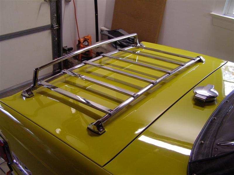

Paul: The 3rd cross member from the bottom has a little speck of bug poop on it. Probably a stink bug. You really should try to be more tidy! :devilgrin:

Thanks for the heads up. I got it!!
Well, this project is off the books and on to the seats and fuse panel next.
