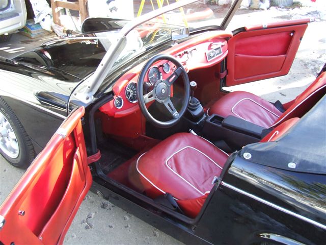

Thanks Bryan. I do not have the patterns, but just made one for the inside pocket. I'm going to try to finish the pockets this weekend. I would like to finish of the entire inside door. Not sure how the original sprites were finished off.

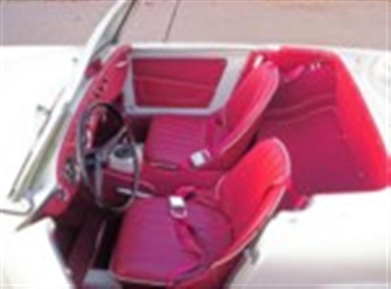

I don't know if they are, but I'll do some checking to see if I can find anything for you . I know quite a few guys with MK 1/2 sprites and someone may have some they can trace out on paper. Another thing would be to post a request in case someone has them already traced out or are in the process of doing their interior too.
Doors were a lot like my MK 1 Midget (picture). Maybe someone like Jack will post pictures of their frogeye doors.

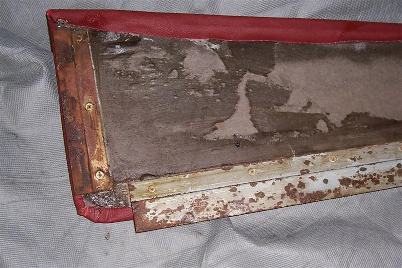

Yes it is. It just kind of runs along the outside of the panel and makes the trim peice a pain. However, when the seat is installed it is not noticeable.
The main difference between the frogeye and the Mk1 Midget looks to be the painted finish on the edges of the frogeye as apposed to the padded finish on the MG. The pocket looks the same.
I will need to rewire. For some reason the previous owner ran the wires on the inside (exposed) of the door panel. That's definitely on the project list.
