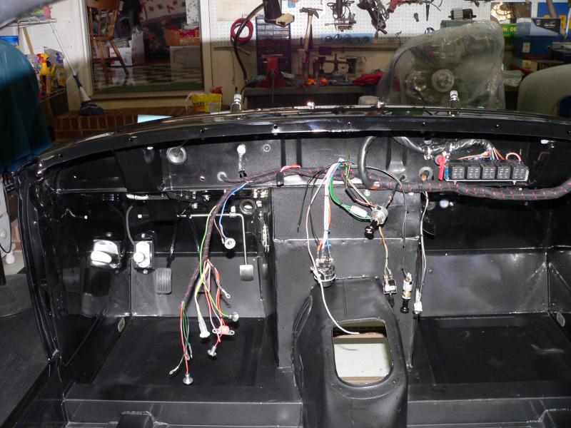

Since I have a new harness for a Bugeye and a 1275 engine with an SU pump, where would the best place be to pull Electrickery from?
