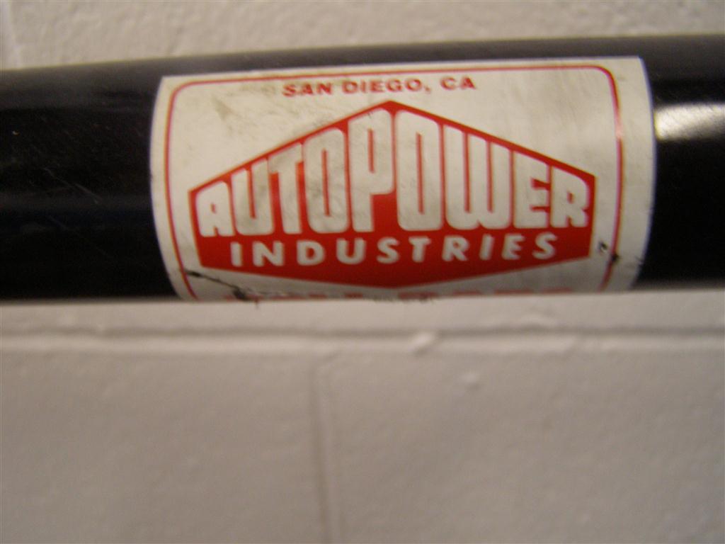

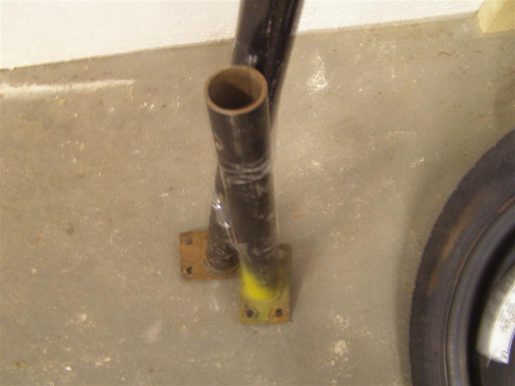

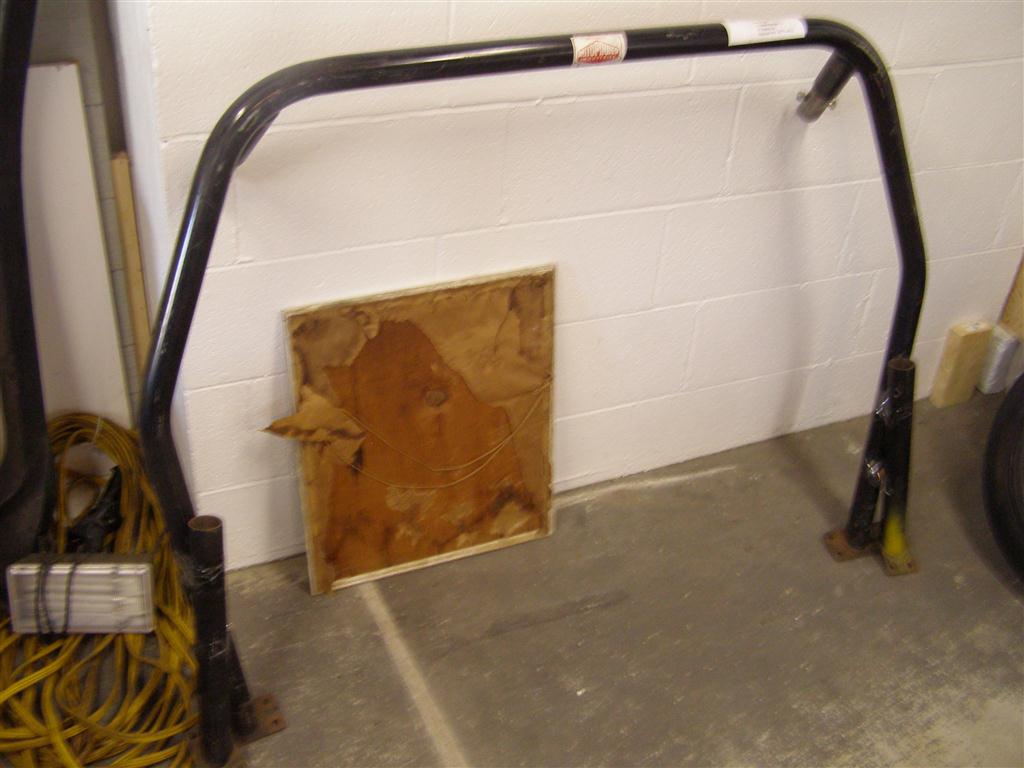

This may stay in my garage for a while. Todd I will have to think about doing all of that. This is the roll bar that Mickey had bought and sent along with the car. I was told that the issue could be at the bottom of the seats, more so than at the top. I knew it angled in there, because of the shape of this one.
I would still like to see just how wide they are to measure against this one, if for no other reason that I want summer to come so I can drive the 6 or the 8 again.... :cryin:

Max width at the bottom is 52". Max width 21" up from the floor is 45"(slightly more if you do away with the plastic cover). Height is about 38" depending on the angle of layback. I have never seen an autopower bar for a wedge. It would be interesting to see if it fits better than the Kirk bars. The new improved Kirk bars fit better than do the older style. The two I have belonged to friends that were both about 6'2" and couldn't get the seat back far enough for their comfort. In both cases I removed the kirk bars and bent up new ones that landed on the same mounting holes, but allowed more seat travel.

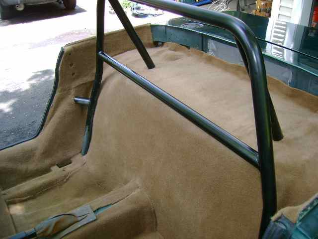

Test fit the bar you have when you get your car back. If it fits well enough for your taste, then go for it. Remember to use backing plates and grade 5 or better bolts to secure the feet. If you want, I can weld a cross bar into the hoop for you. SCCA hoops will have a diagonal, but for street use, I like a straight across horizontal bar just above the seat back and below the head rest. This helps stiffen it up a bit and also provides a good place to mount four point seat belts if you want to do a little autocrossing with the car.

I might want to do that section, prior to painting, of course. Thanks for the photo. I took the seats out for new padding under the new upholstery and I should have done it then, but the trim shop did for me in two days and I just wanted to play with it then.
When A&E put the roll bar in my TR6 after painting it, they put plates under every pad. Can you get at the ones on top?

The pre fabbed ones should come with small plates to go under the car. The feet that mount to the floor are difficult as the bottom plate and bolts are hard to locate and attach under the car, because of the floor contour. The ones that mount up on the rear deck usually end up somewhere above the rear tires. I have seen many an install where the bottom plates were left out and only the bolts were installed. Kind of defeats the purpose of a roll bar if the bolts rip through the floor in an accident don't you think.
