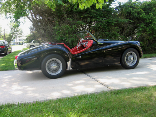

Don't know what you're into, but I went with 72 spoke in a wider wheel (5") so I could get 185-70/15s on. Not much more money for the wider wheels, and probably wider choice of tires. Of course I got crazy and went for the Vredestiens because I liked the vintage look and they're supposed to be a very good tire. :driving:
Edit: As you can see, the 72 spoke wheels are a lot "busier" then 48's.
