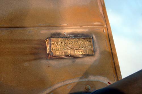

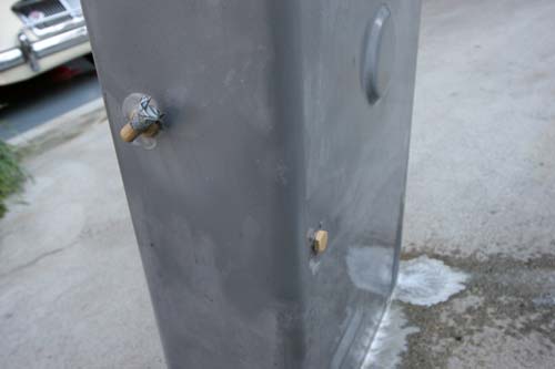

They also sell a phosphoric acid solution called Metal Ready which you are supposed to prep the surface with first, then rinse with water. At that time you will see flash rust occur, and this is desirable. Here is a shot of the YB tank above, just after rinsing off the Metal Ready.
Notice the silver bare metal in the first shot. Now notice the rust colored metal in the second shot. This is what happens as the surface dries. I used a shot with a brass tag in it for color comparison.
