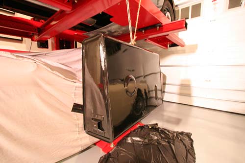

I media blasted my last one and then coated it in etching primer and Satin Black Acrylic Polyurethane. That'll teach those rust bugs from mucking me up again.
That looks darn nice! I blasted the tank from my YB and coated in POR15 semi-gloss. It hadn't dried yet in the picture.
