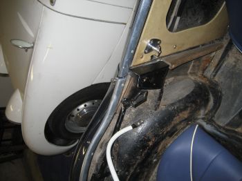

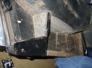

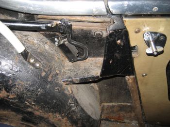

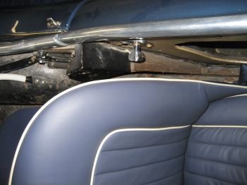

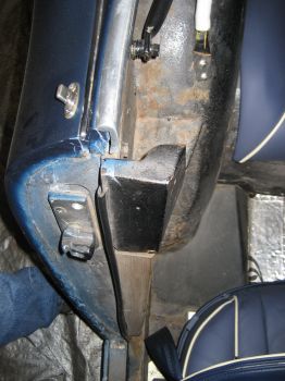

So you work on your car for years and you do a little bit (or big bit) at a time, and you think you know what's going on, because you look at pictures, read books, get advice, etc. Then one day you get to a point where you're looking at something that you've seen hundreds of times before, and it looks like it doesn't belong on your car. There is a piece of vinyl covered wood that runs from the floor to the top of the door frame, in front of the wheel well. See healeysix.net, Longbridge car, page 2. On my car there is a metal box like thing at the top, in front of the top frame slide mechanism, about four inches square, which I think doesn't belong - see pictures. Can somebody help???

longbridgehealey, i can only tell you that Ive searched for manufacturers of replacement panels and all the obvious catalogs and as many pictures of these cars as i could locate but have not found a piece that looks like the one in question, yours looks pro. done though.
Yes, that's what I thought. But I have figured out the wooden piece. There are actually two, and one is shorter than the other. The old one in the picture is the shorter of the two, and only extends upward to the "boxlike piece". The other wooden slat is shaped just like the one in the picture, and extends all the way up to the top of the box like thing. I'm still trying to figure out if the box (I don't know what else to call it) belongs there. It is mounted beneath the track for the top frame, and seems to belong, but I can't find any references to it anywhere.

My car has the same "box" in front of the slide and it adds a lot of rigidity to the area.There is trim peice that covers it and is a PIA to fit. Look carefully at the pics on the page on the longbridge top.
Yep, I think the box belongs there. I'm pretty sure the trim piece that covers it is moss parts 806-370 and 806-380. And I do see it on the Longbridge top page. Doe it screw on from underneath, or crimp onto the box, or what?
