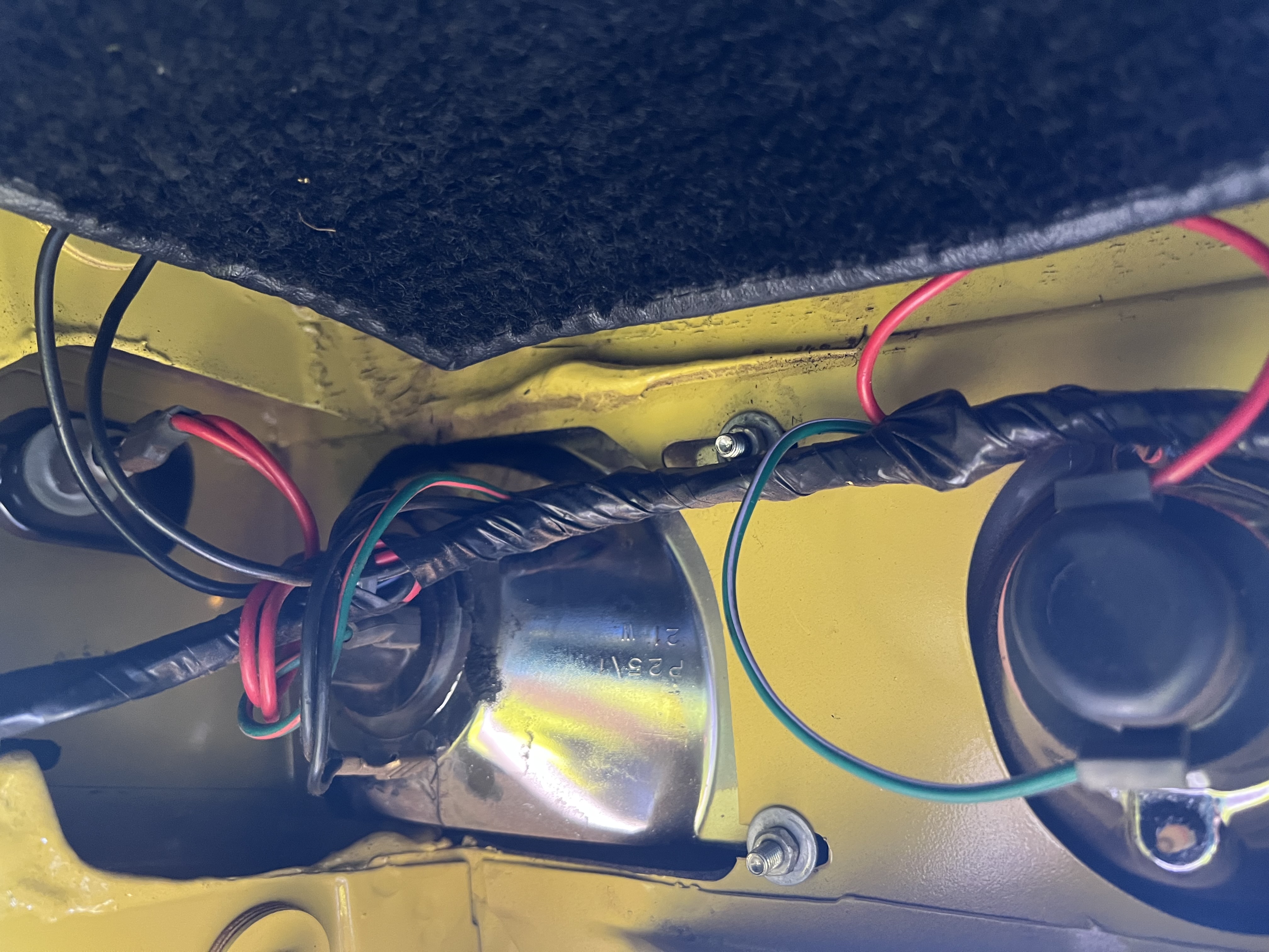

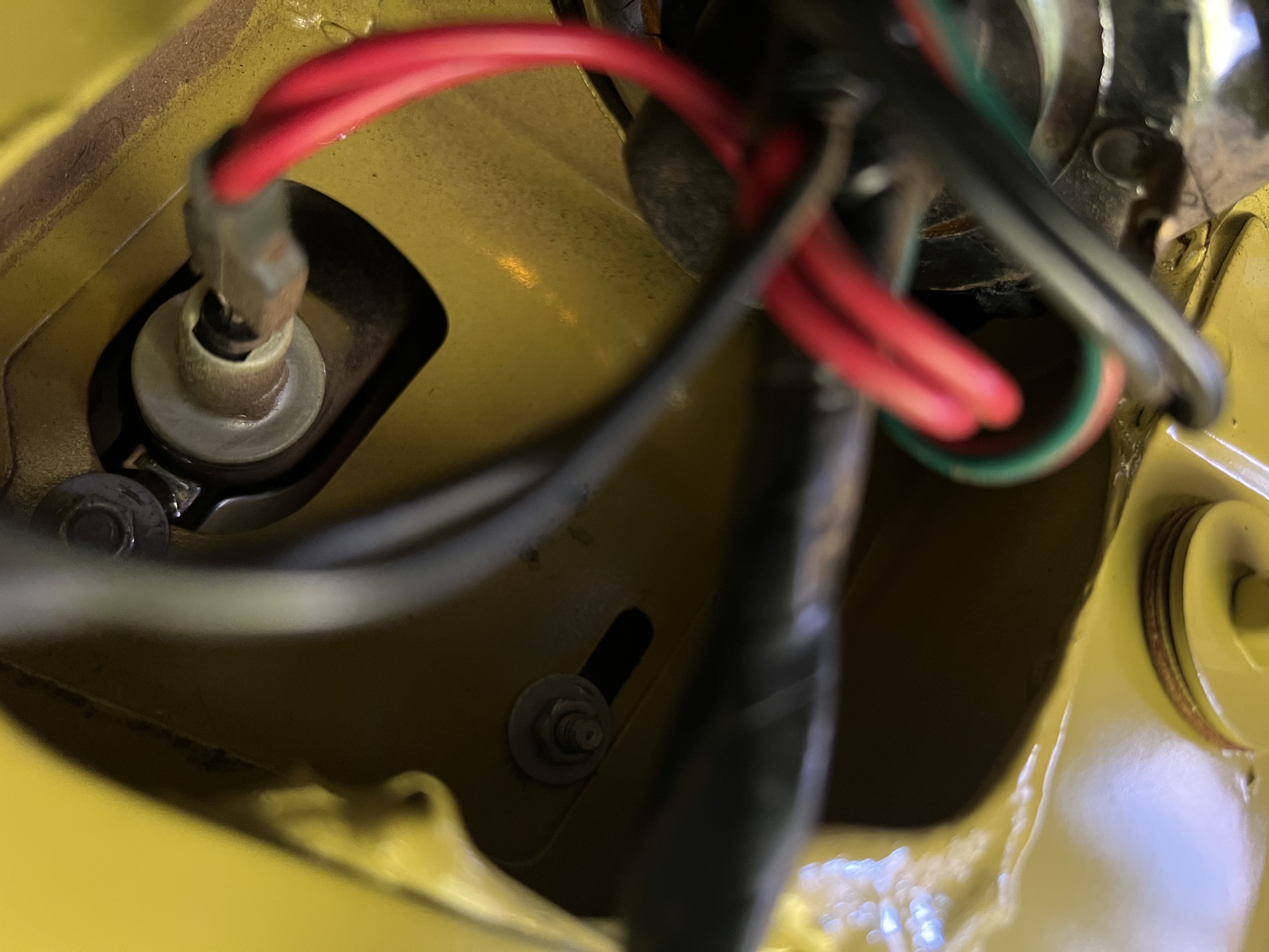

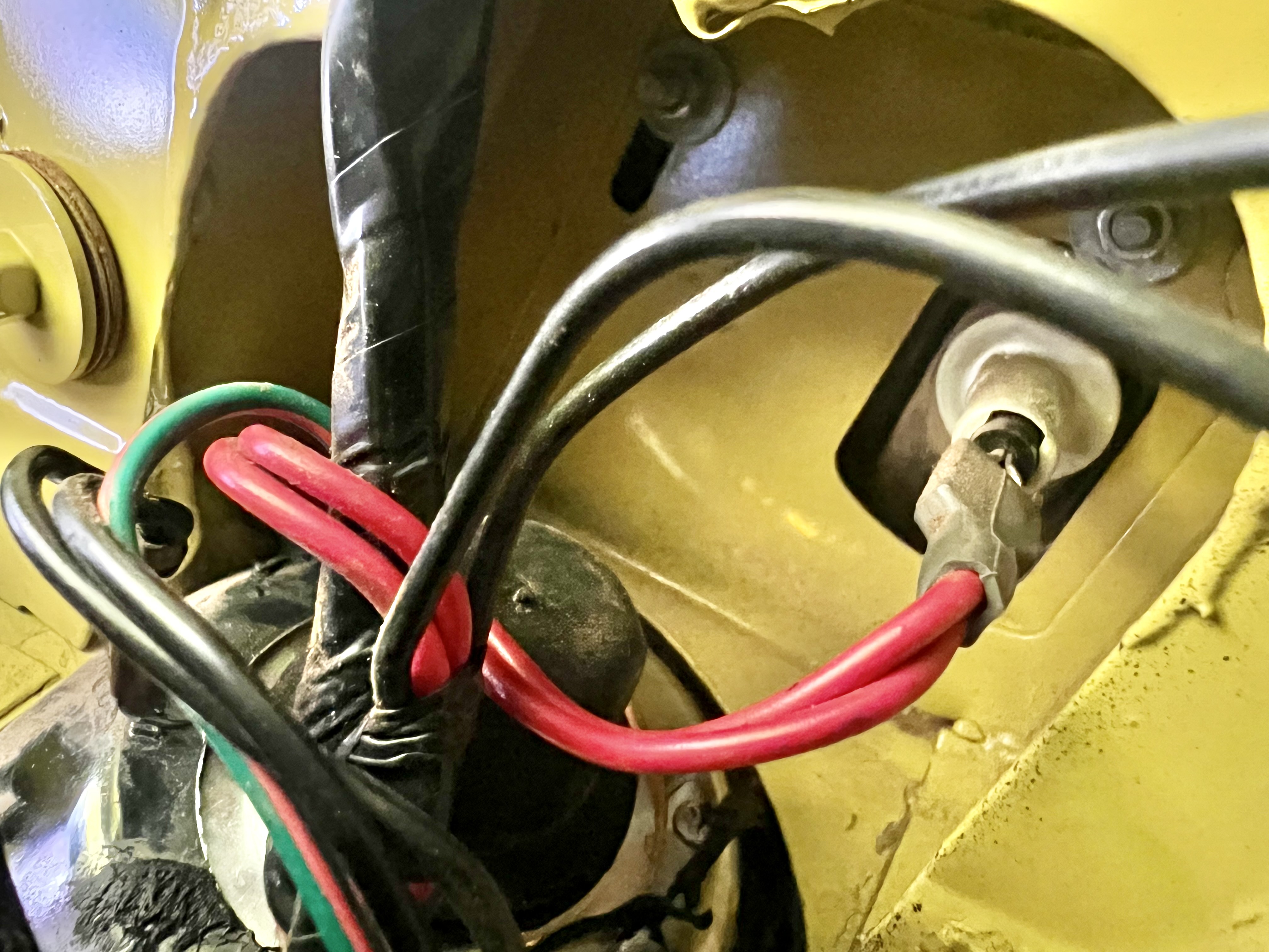

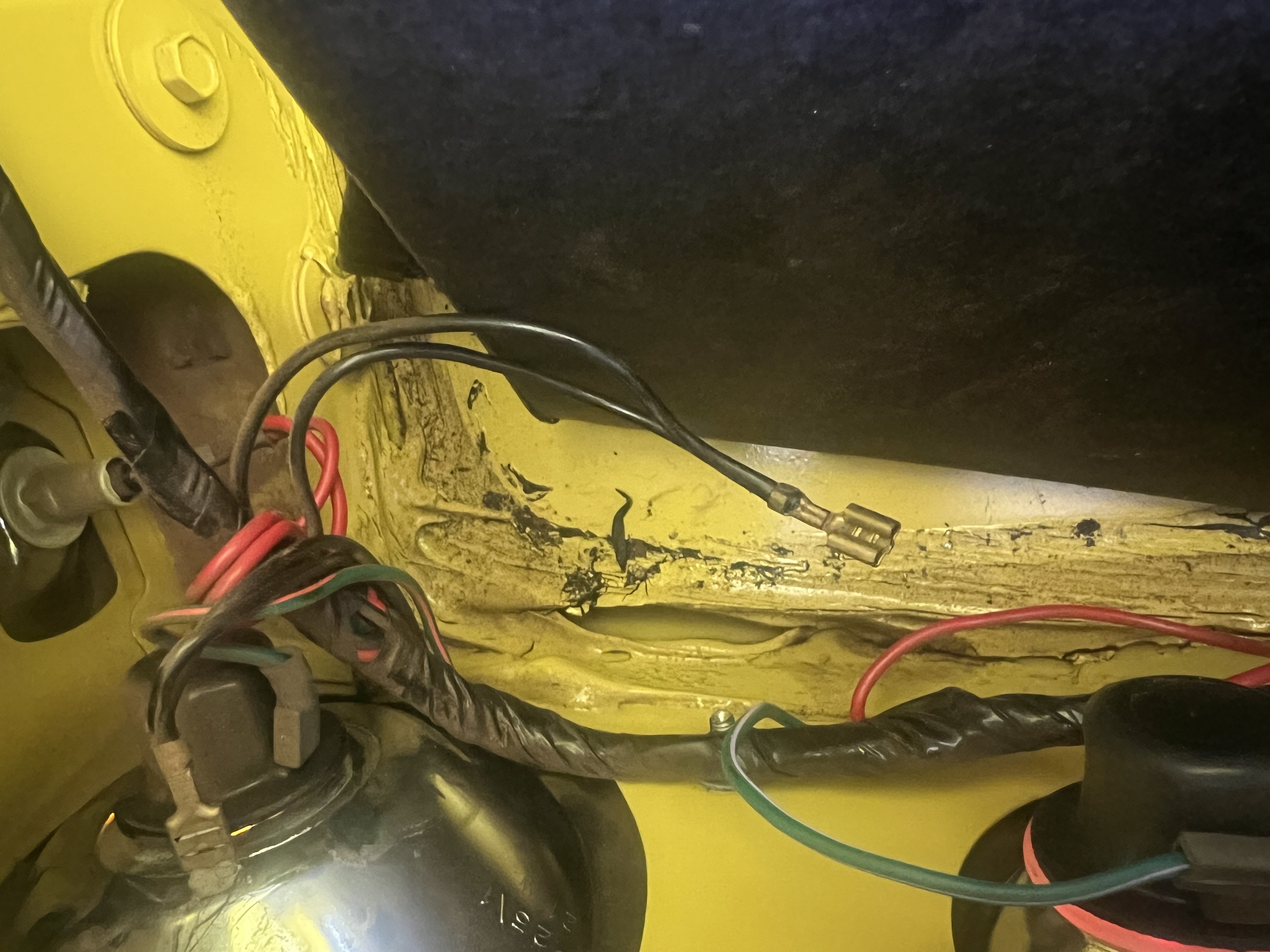

Hello,
I’ve stated a thread on The Triumph Experience and received lots of feedback, Unfortunately, I haven’t solved the problem with my fuel gauge not working and I feel like I’ve exhausted the topic there. My car is a 1975 with 7k miles so the wiring harness is original. Let me get you up to date with my issue of the fuel gauge not working. I’ve replaced the sending unit and voltage stabilizer. The gauge reads full if I ground the green sending unit wire. Doesn’t that mean that the gauge is not broken? The temp gauge works fine. I’ve heard that they get power from the same source. The fuse is good. I suspect the problem is with the fuel gauge ground. I tried tracing the sending unit ground by feeling the wiring and part of it goes back to the rear left tail light. Back there, two wires are not connected to anything and I don’t see any empty connection points- see pictures. I don’t know if it’s related but the rear blinkers illuminate but don’t blink. Getting back to the fuel gauge, where is it grounded? Is it in the engine bay? My car has a/c so getting behind the gauge is really nearly impossible. I’m hoping that it’s a simple, easily accessible ground wire problem. All help is greatly appreciated.

The 2 wires you show in your first Pic are black. That means they are ground wires. They do not necessarily need a place to go but if they are within reach of something like your fuel gauge sending unit that would be highly suspect of belonging there.
Is there a ground wire coming off of the sending unit on top of the fuel tank? There should be.
It is also advisable by folks who understand these things that, you should also have a ground on the casing of your fuel gauge.
The body of your car is your ground source. So find a place or bolt that is unpainted/ bare and attach the ground wire there.
Your problem is that you do not know if the 2 black wires are leading a ground to something or looking to ground something on the other end. You need to test those wires to determine which way they are intended.

That connector should go somewhere, and not just loose. Find that and you are on your way to figuring this out. Also...what exactly does your fuel gage do?

That's always the rule with British cars...if something doesn't work right, it's the ground!
Thanks everyone. I’ll attach the black ground wires that are near the left tail lamp. I held it to a ground spot but it didn’t seem to change anything but I’ll still attach it permanently. The fuel gauge shows empty. I grounded the green sending unit wire and it went to full. There is an attached ground wire at the sending unit. I guess I’ll have to get at the back of the gauge but with a/c, it’s a pain.

The fact it has 2 wires tells you that it is not to go to ground, but to be used to ground something. You can check with an ohm meter wires to ground, but I bet they are grounded in the harness and meant to ground something around the taillight.

I’m not sure exactly what fixed it but I did connect those ground wires to the turn signal ground.

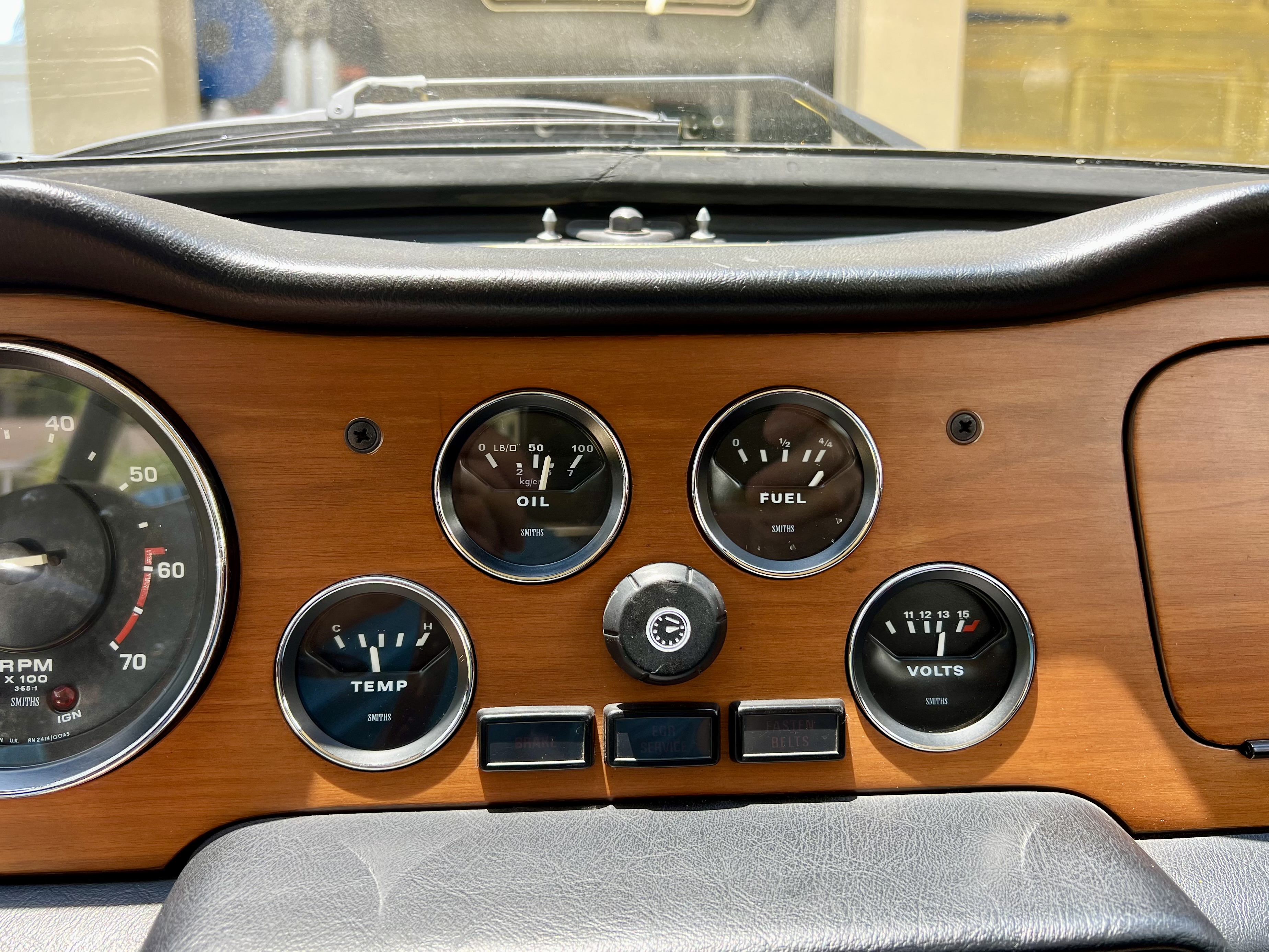

I removed the gauge and broke the bulb. It’s always something…

Wow! Now I can’t get the bulb to screw into the receptacle. Like I said, always something.
If you remove the ashtray in the center of the padded dash you might be about to change the bulb through the opening.
That’s what I was doing. I kept at it and finally got it to screw in.
