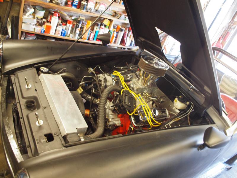

I just drug home A 65 sprite from canada with a buick V6 a th350 trans, a 9" rear axle.
The car was built in Canada as far as I know, the frame is boxed in and all the work is very well done that I have seen so far.
Yesterday I made a couple of real simple changes to the carb and took her out for a quick spin. This is possibly the fastest car I have ever owned.

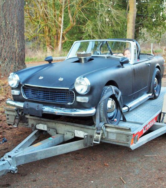

Wow. That's a really impressive build. Any idea whether that is the earlier "Dauntless" V-6 from the 60s, or the ubiquitous 3.8 Liter, 231 cubic inch V-6 one from the 70s through the 90s? Based on what Buick did with their Grand Nationals in the 80s, the 231 can definitely handle modifications. It doesn't take much to get a Sprite going fast. If you want to check out the "next level" - check out anarchy99's build on the "New Guy with a Sprite -- sort of" thread.

It's later than a 65 because it was designed for the non removable top. Has a steel dash so it could be a 67 but the rear wheel arches make it a 72 or so. Guess its what ever the guy could get a title for! Looks fast and the mod's could hide under the bonnet pretty well with a small hood scoop.

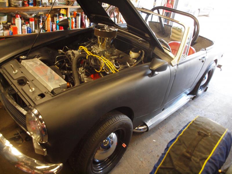

The motor is a 3.8 balanced and blue printed even fire with a holley 570 4bbl, with a high rise edelbock intake. The car has line lock with a th350 trans.

The body numbers are all on the front half of the car so I would imagine that is a 65. From the back of the doors on back it appears to be a 72 which had round wheel arches and would be desirable for fitting bigger tires. That would be my guess anyway.

Honestly, you don't have enough motor to justify that much trans and especially that rear end. If it hasn't been cammed you might want to think about putting a super charger on it. Maybe an eaton off of a 90' whatchamacallit. Those drawn in from the back. With some skillful fab work you might be able to make it top draw.

I'll send you whatever info you want, I've had everything from a 283 sbc, to a magnacharged ls6, to a sbc 350 with a 142 blower, to my current setup, which is still a sbc... Various trans setups, now with a 200-4R all in a sprite. If its going to come through the hood, might as well have fun with it. Send me a PM if you need info etc or just wanna shoot the **** on it.
Kurt.
The door cards are from a later model as well.

Reared was cut and in when I got it, I went through it and rebuilt it when I had everything torn down, it was cut down all the way and axles cut and resplined
