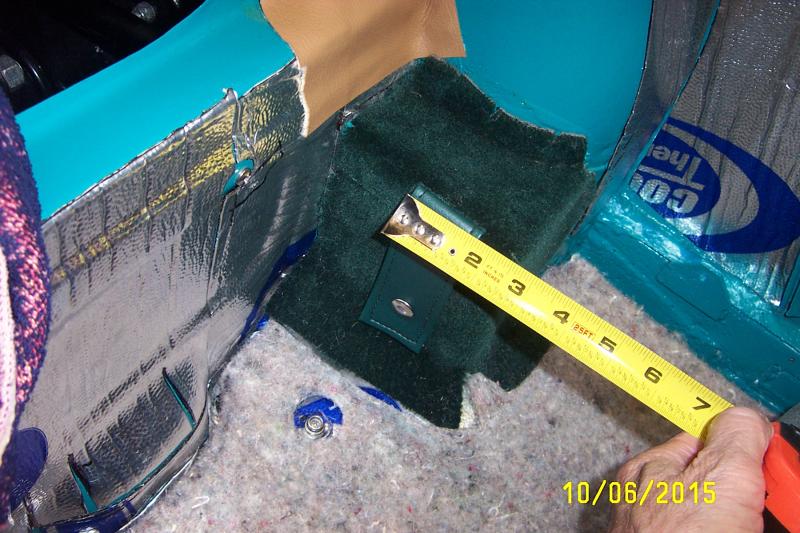

Am making carpet set for BJ8 PII and need the dimensions of the carpet flaps with the snaps that cover the radius/torque boxes. The old carpet set did not have them.
How long and how wide are they approximately and their location. Closeup photos would be great especially one showing the carpet flap up exposing the hole for the suspension bolt.

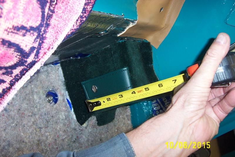

Re: Need dimensions for BJ8 PII radius [torque] box carpet flaps.-I just guessed!
Since we got no replies we guessed at the size of the flap based on the few photos I could find. But anyhow here is the result so maybe can help someone else who wants to make their own carpet set. Not sure how they match the originals but when complete should look okay.
