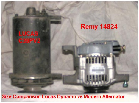

TR2/3/3A Need alternator dimensions
angelfj1
Can someone help me find a dimensioned drawing for a Remy alternator part #14834 (re-manufactured) or #94623 (new). I have found dozens of companies who make a compatible alternator but no one provides detailed dimensions. This alternator fits Suzuki Samurai and Sidekick 87-95 and Chevy Sprint 85-88
I need the dimensions to fabricate a mount to use this alternator in a TR3A.
Thanks, Frank:joyous:

Thanks Guy, and yes I have considered those "stealth" alternators. There is anecdotal evidence that in the TR2, 3, 4, 4A application that they eventually succumb to the heat caused by close proximity of the exhaust manifold. They are stuffing a lot of heat producing kit inside of a metal cylinder, whereas the original stuffing was intended to be applied in open air. The other issue is the time to resolve complaints, repairs, replacements and cost of shipping, duty, etc.
There are a few companies here in the states producing these units but not one that fits the TR's yet.

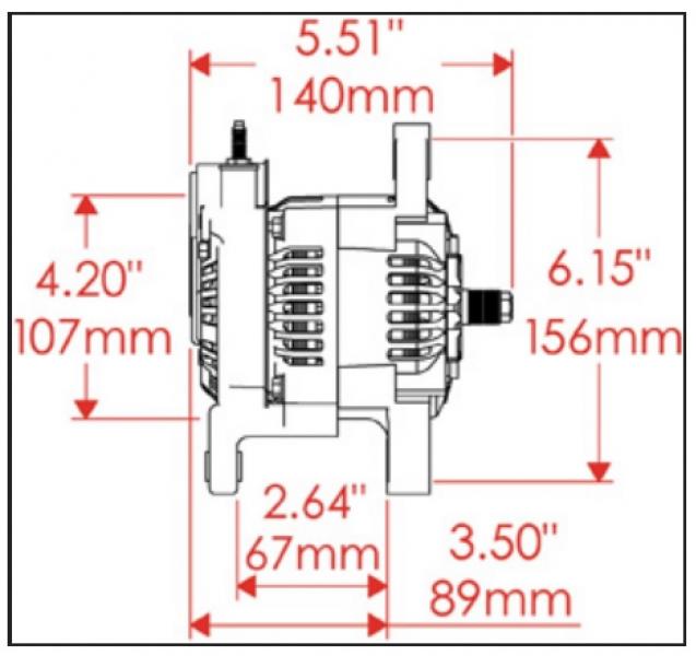

I'm not trying to sound cheap, but retired life does impose some financial restrictions.:blush: So, if I buy one, it has to be right. Does anyone know a supplier with a liberal return policy. Usually electrical components are non returnable!
OK, this is what I was able to find, but I can't verify it with another source.
attachment.php
Thanks, Frank

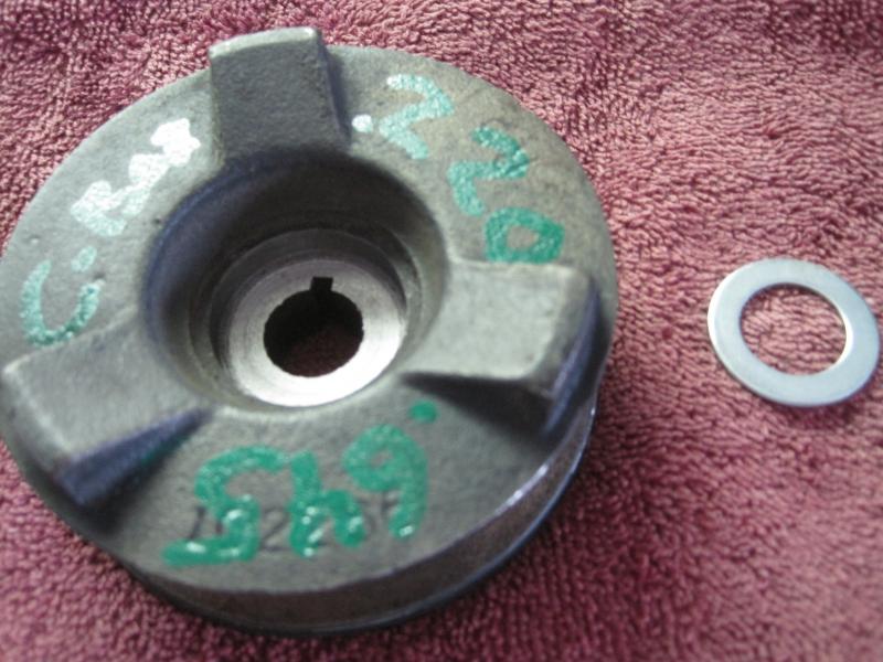

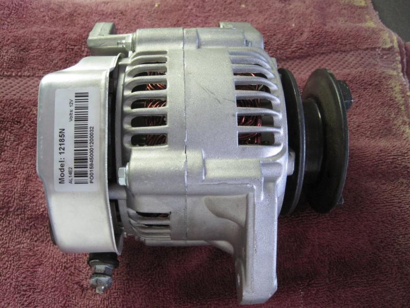

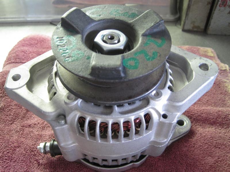

'll add my .o2. I used a Denzo 12185N unit. I wanted to stay with the wide belt because I didn't want to give up my fan. I had to open the bore on the pulley (sheave) to 0.645" to fit the shaft. The shaft wasn't long enough to catch all the threads in the nut so I counterbored the outside face .220" deeper. Then, the pulley rubbed on the alt housing so I placed a .030" shim washer between the pulley and the alt.
The guy that sold me the alternator installed an internal kit the enabled a "one-wire" installation. I'm very satisfied with the set-up.

Lukens, many thanks for the explanation and great photos. :smile:
I have a couple of questions.
1. I don't have performance data on these alternators, so you find that the original pulley is driving the alternator fast enough to charge the battery while idling, like at a red light?
2. We were concerned about removing material from the pulley. They are cast iron and at higher speed could come apart. This is why alternator pulleys are usually made from steel or billet aluminum. On the other hand if you continue to use this original pulley it;s spinning no faster than the original generator.
Yes, please do send some photos of the way you mounted the alternator. We were concerned that there would be interference caused by the inner fender.
Thanks again and best regards.
Frank

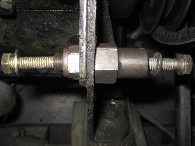

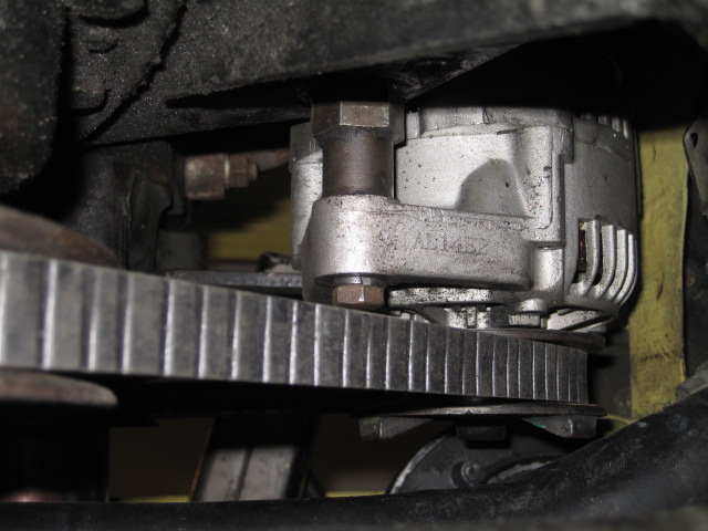

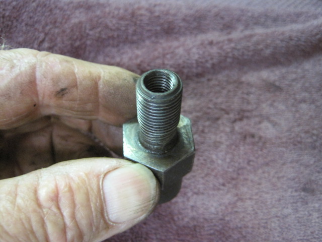

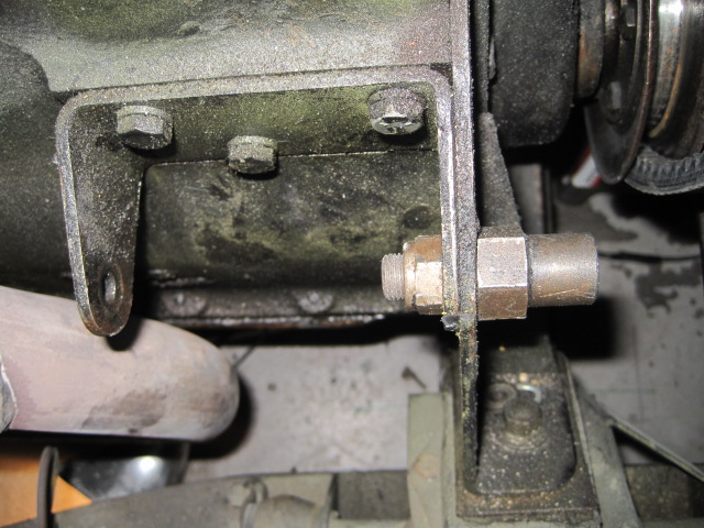

Frank,
Concerning whether the alt spins fast enough to charge the battery: Yes, under all conditions. I understand it to be a 50 amp alt. I have driving (fog) lights and a pusher fan... never a problem. As for the integrity of the pulley, I believe everything 50 years ago was over engineered. I don't believe the counterboring weakened it at all. Now for mounting. I'm not sure this is the simplest or best method. It's just the way I did it. I should also point out that I did this when the manifolds were off the car.
I started by sawing off the steering column bracket on the drivers side... I'll never use it. This gives a little extra clearance. I found that by cutting an inch off of the adjusting link, I could bet more "swing" out of it.
attachment.php
Here's a pic of the stock "pedestal" (Triumph's word), and the support bracket:
attachment.php
Here's how I altered the pedestal:
attachment.php

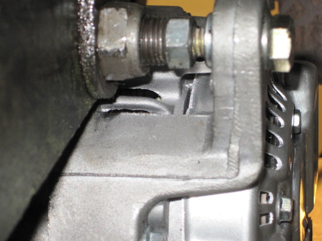

I drilled and tapped the threaded end for a 5/16 - 18 bolt. The "big end" was already drilled and tapped to receive the bolt through the lower foremost generator mount, however I did face .100" off this big end to allow for belt alignment. I guessed at .100" thinking that I could add shim washers if it was too much. As it turns out, the pulley on the alternator is right in line with the waterpump pulley.
I didn't use the rear tab on the support bracket. I attached both of the lower ears of the alternator to the front tab of the support bracket. That along with the adjuster bracket provide ample resistance to the alternator twisting.
This is the arrangement I used. The front bolt locks down on the front ear. The rear bolt passes through the rear ear but doesn't pinch it. I only provides alignment
attachment.php

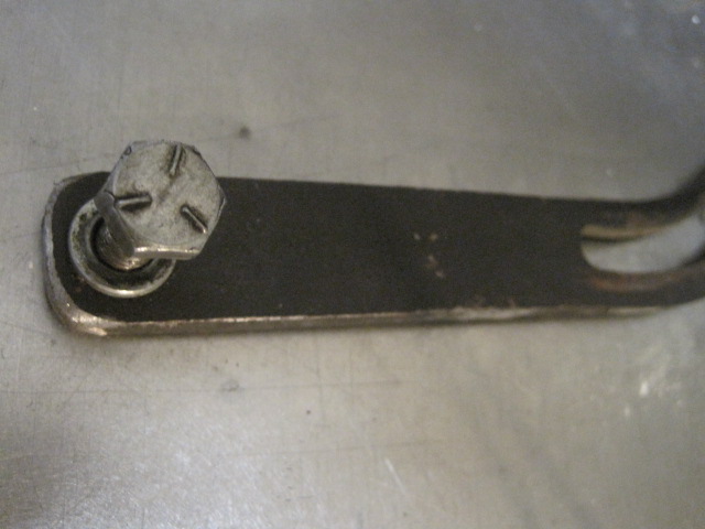

Here's a picture from under the car. It's a little confusing because I added a jam nut to the rear screw to keep it from vibrating out. I didn't run the rear screw so deep in the pedestal that it would "bend" the ear... it's there for alignment only.
attachment.php
Here's the front screw that really locks the alternator in place:
attachment.php
I'm sure there are better ideas, but this worked for me.

Russ, this is outstanding!!! Your photos and description are crystal clear and leave no doubt as to the way you achieved this modification. Thank you so much for your help. I hope to report on my conversion soon.
Best regards, Frank :tennis:
