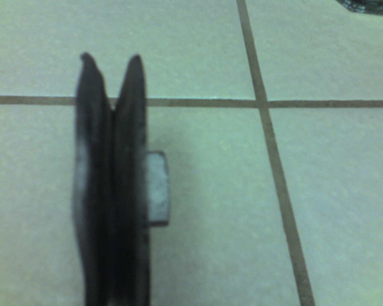

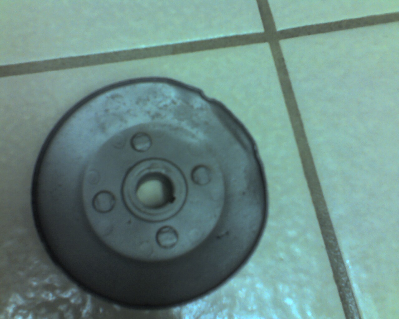

I've been cleaning up parts and started on the generator. My pulley looks like it has seen its last days. It comes from a lucas c40 generator/dynamo. Any leads on a used source (<~$89 from the suppliers).

Is this for a mechanically driven tach? If so, I got one. Measure it and let me know what the outside diameter is.
Is this for a mechanically driven tach? Yes 3 5/8 OD. The ID of the shaft is difficult to measure as it has been roughed up-also. It has a keyway and is rivited.

The id are the same for all years, (I believe.) The od is what you need to worry about if you are running a mech. tach.

Just Curious... what is the correct size of the pulley for a tach drive generator? I picked up a used generator, that has the tach drive, but I'm not 100% sure it came from a bugeye. I think so T series cars also used the tach drive, right?
3 5/8" od. The tack will not read correctly with a different od. I had a smaller pulley from, i imagine, a later spridget. Tach was reading about twice as it should.
