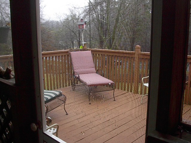

Our second story deck has some rotten boards on it,
& will need to be replaced in a while.We got one estimate
that was kind of a shock.
We could go wood,or a Trex-like material.Wood requires
annual staining,& Trex doesn't.I'd prefer a low-maintenence
material.
Any thoughts/ideas/suggestions?

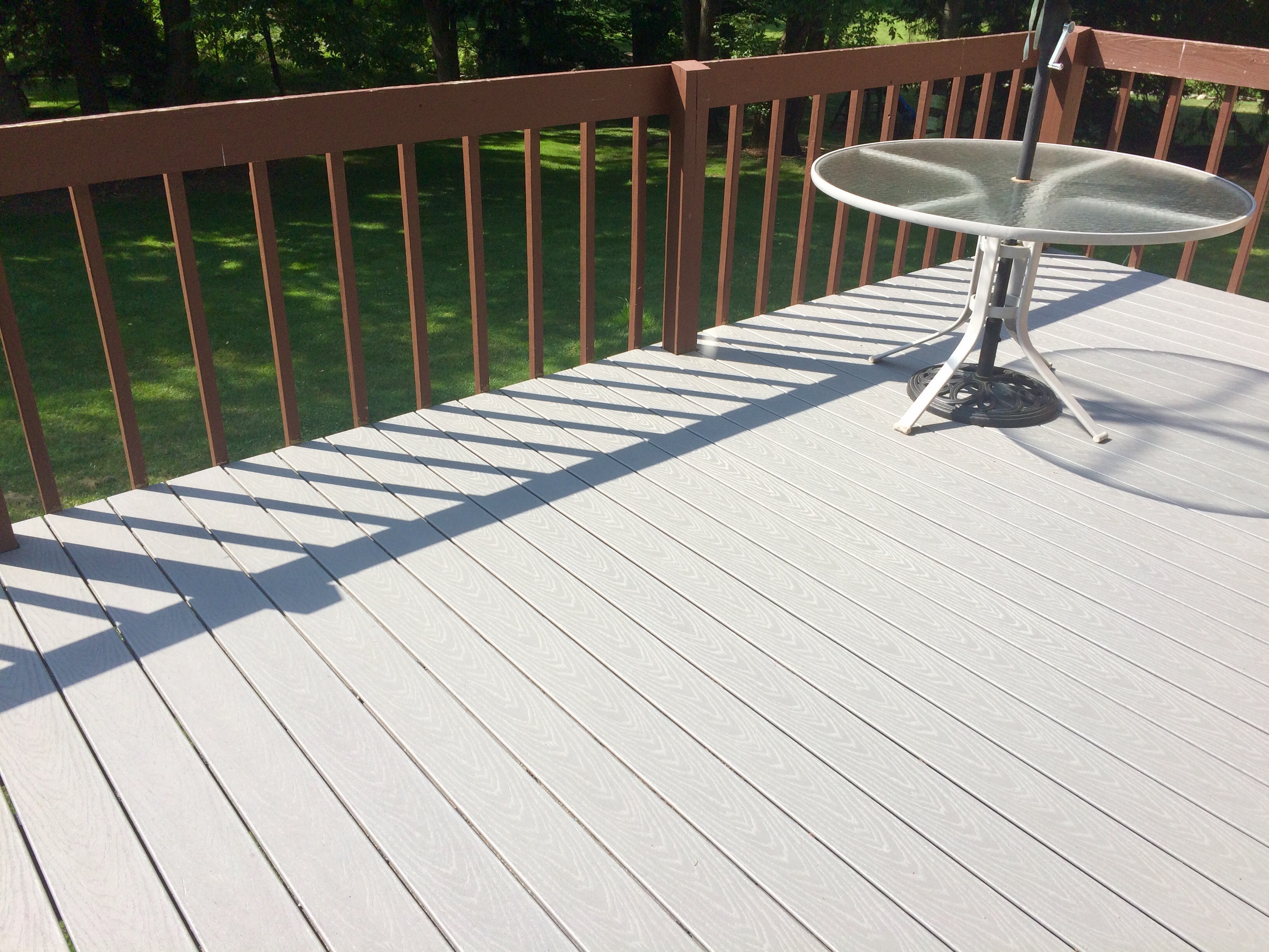

I'm going to have to disagree with you Tom. I replaced my wood deck boards with Trex about 4 years ago and it never gets too hot whatsoever. My deck is facing south so it gets the sun most of the day. I purposely selected a light color to reflect rather that absorb the sun.
I don't miss the maintenance of wood at all!
Elliot - that was probably my problem. I had a darker color (like the previous wooden decking). Bet if I'd chosen something like you have, the heat problem would have disappeared.
Thanks.
Tom M.
