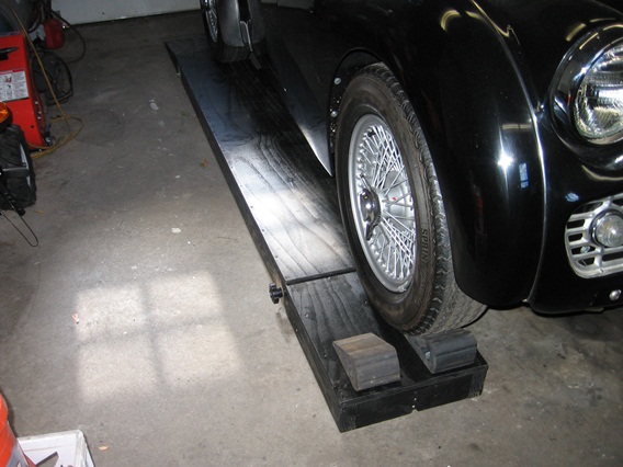

I was looking at that lift myself, but finally settled on a scissor mid-rise as shown in this thread...
https://www.britishcarforum.com/bcf/showthread.php?86059-Lift-for-the-Garage&highlight=lift
Unfortunately, I haven't got it totally hooked up yet, as I had some hospital stays get in the way of finishing the installation. What I did have to do however, was build a couple of ramps, as the front sway bar on the TR3 hit a part of the lift where the pistons connect. Here's a pic of the ramp(s)...
Edit: Actually, that pic is not so good, as you can't see the ramp part at the back of the car. Maybe later I'll take another pic that better shows the construction.
