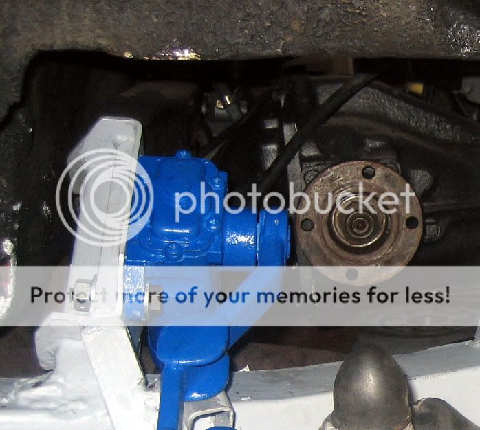

DPO Pedro had the near shock side mounted with a thru-bolt,
full thread metric bolt and nut. My new American bolt would
not thread withour major effort. Metal shavings appreared.
So I purchased the Craftsman tap & die set to clean it up.
I installed a 7/16" fine 20 thread, grade #8 bolt with #8
metal lock nut, washer and blue Loctite. All torqued exactly
as per Bentley blue book. Loctite along entire bolt shaft.
As per Bill's suggestion, I installed only metal lock nuts
and Loctite blue on all threads. Everything in today's
rear suspension rebuild torqued as per Bentley blue book.
Thanks for your help, as always. /bcforum/images/%%GRAEMLIN_URL%%/thumbsup.gif
Photo of installed shock:
Looks good. Use the same on both bolts.
This has always been a weak mounting point and many people weld a brace across the bracket to "box it in" and add strength.
