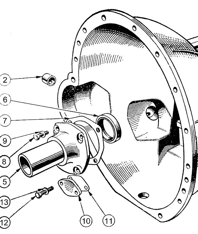

Somebody else will have to tell you if your tranny is built like this, Ed but if it is this is what it'll look like. What you can't see is an oil seal in the front cover that surrounds the splined input shaft, and a gasket between that cover and the case. There is also a gasket between the countershaft end cover which is out of sight but located just below the front cover. If you are leaking tranny fluid any one of these 2 gaskets or the oil seal could be responsible.
Not exactly like that, but very close. Here's a diagram showing the gaskets & seal.
The seal is the most likely culprit IMO, but it's worth noting that the washers (9) and (13) are supposed to be copper sealing washers. Since the threads go through into the inside, an ordinary flat or lock washer can cause a leak.

These illustrations give me a much better idea of what I am seeing and what may be causing the problem.
