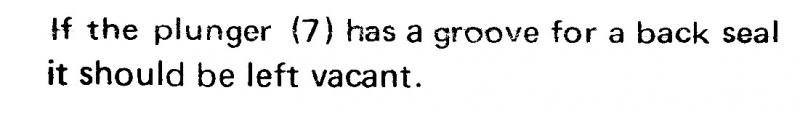

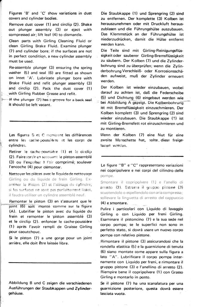

FWIW, Girling deleted the rear seal and said to leave the slot empty.
https://i258.photobucket.com/albums...es/Girling Master Cylinder 2 raw.jpg~original

Yes leave that rear seal off the plunger because if it does not have a perfect fit the piston will drag and the actual clutch will slip on the disc. I think the piece was only felt anyways perhaps to keep dust out of bore. I replaced one once with an O ring and caused problems.

Randall, sp53, I'll leave the rear seal out.
FWIW when I applied air to the cylinder and pushed the plunger without the rear seal, it would leak if pushed off center. With the seal. couldn't get a leak.

Understood. What's the negative to using the rear seal/
CJD
I think Randall mentioned that earlier...more drag can cause the piston to lag or stick when returning to the full out position. It's sort of a "Catch 22" situation. If the main seal leaks, the rear seal will prevent the fluid from escaping...but if the main seal does leak, the MC is already broke and needs repair.
