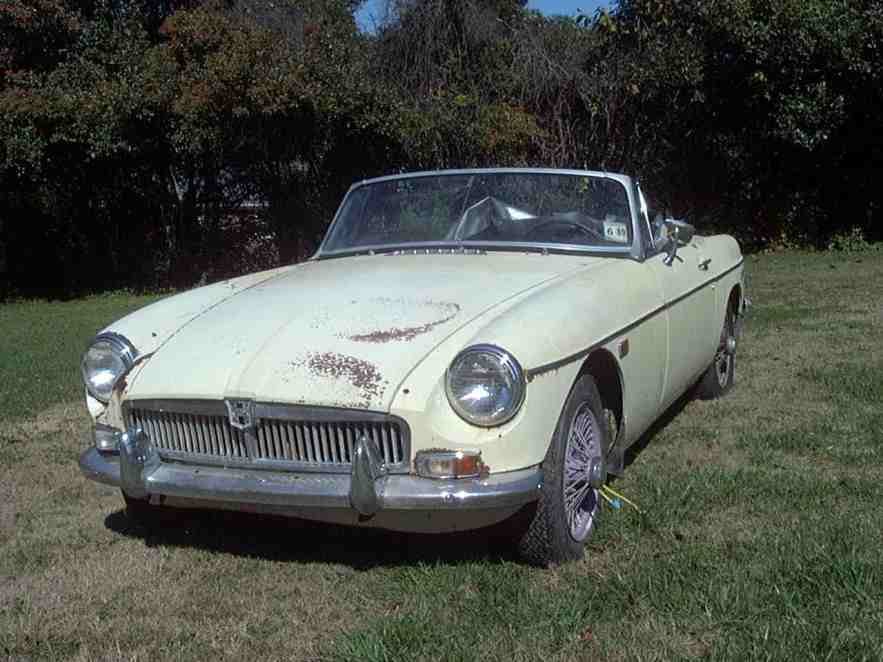

Here is a 69 that i started the restoration on 2 days ago. The new floors are in and the minor body rust will be next.I have always wanted to do a primrose yellow car. The floors went in fairly easy. More pics coming as i make progress. Bob

left side is good and the right side rocker panel has to be replaced. both dog legs and lower front fenders need some work. If the castle rails,trunk floor and quarter panels above the rear wheels are good then its all simple repairs to me. The car has been parked since 86. I cleaned the points and put fuel in the carb float bowls and put a battery in it. It started right up. It will be a great core engine to build. I will try to post a pic of the 72 MGB that just rolled out of the garage. More later, Bob

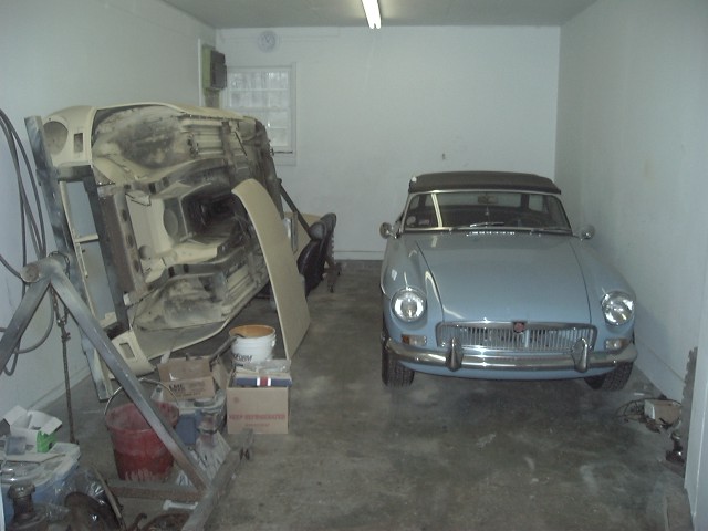

Here is a shot of the yellow 69 on the rotisserie. The body is in final primer and now for the scrape and clean and yellowing of the underbody. bob

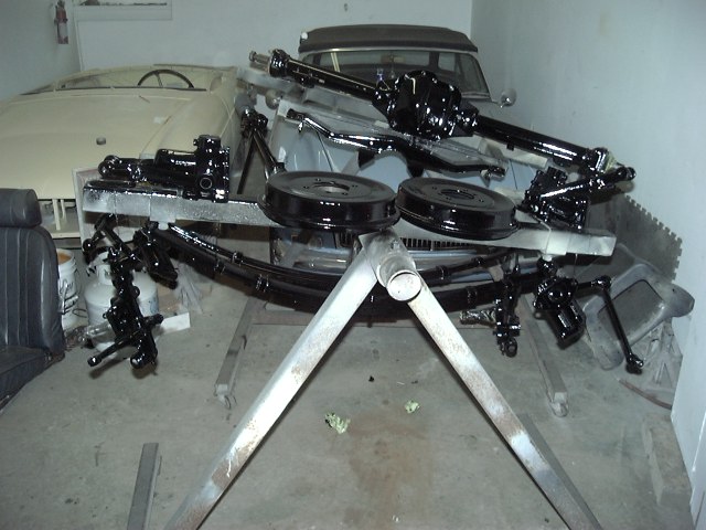

yesterday i sprayed some of the black parts. The Explorer is full of powder coated suspension and the heater and under hood black bits. Its starting to shape up. I only mess with the car when its not freezing cold in the garage. Bob

Are the pars in the pic powder coated or painted? If painted, what did you use? Those are nice and glossy and looks like a really nice project.
The parts in the pic are acrylic enamel. I try not to use spray bombs.I can do nicer looking paint than the powder coat. Also BLACK powder has a bit of a brown cast. The parts in the pic are things like a steering rack, shocks, rear springs and king pins...parts i would not send to have powdered. This stuff will look good up to the primrose yellow on the underside of the car. Bob

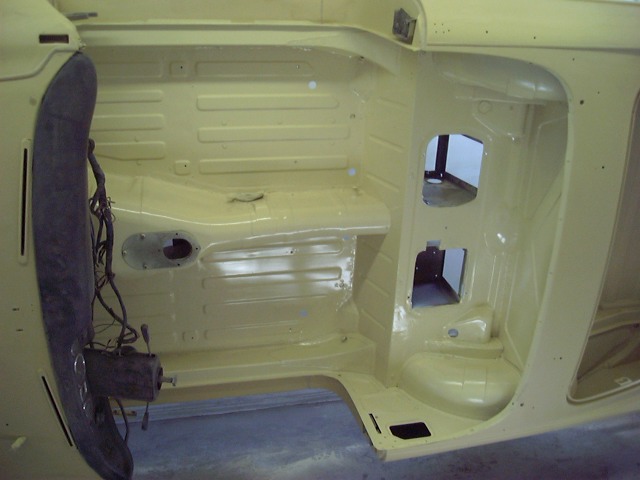

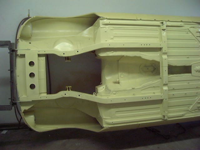

Here are more up to date pics. The passenger compartment floors are painted and the underbody is also painted. I will try to do the engine bay,trunk and door jambs this afternoon.If y'all get bored with the restoration pics just let me know. bob
