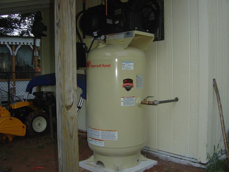

my new compressor, 24 cfm at 175 psi
I might have over did it but then again maybe not
drool guys drool!

Nope, never have too much compressor.
One suggestion, though, you might want to use a section of flexible line between the compressor and the wall.

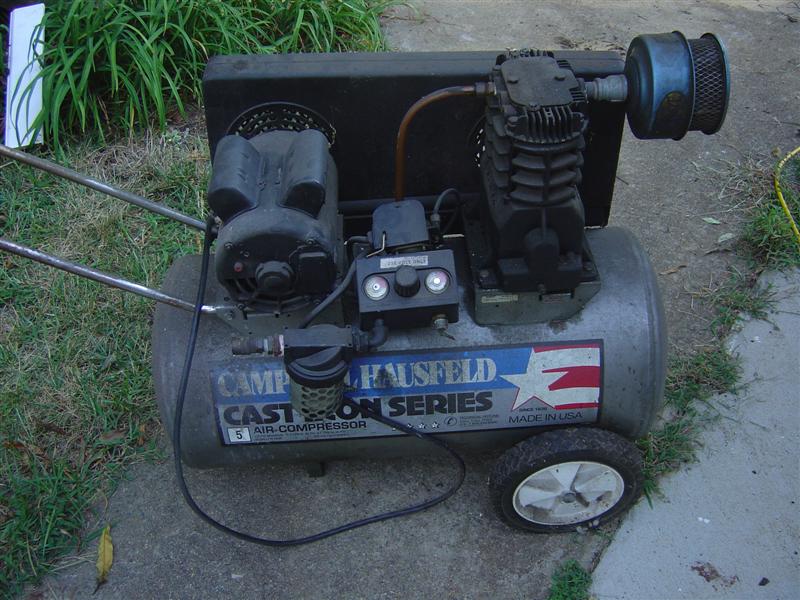

How much ya want for the old one? It looks nice compared to my tire inflater.:smile:
I am curious about the material composing the pad you have the new one mounted on, it doesn't look like concrete on my screen. When I mounted our compressor at work, the boss insisted I put rubber doughnuts above and below the feet that the mounting bolts went through. We used discs cut from a mud flap I think. We also used a flex hose. Don't know if it was worth the trouble or not, but he was paying for it. Congrats on a nice unit and have fun.

I do agree with the flexible line between the unit and the garage.
Sorry Dale the old one is spoken for, taken it to my friends beach house so we can pump up golf cart tires and beach toys
Where do you get the flex hose? Thats probably a great idea, my hard line runs just inside the shed to a filter regulator. The pad is just a 24 x 24 inch slab purchased at Lowes with anchor bolts so I dont think vibration is a problem and the manual just said attach to the floor, nothing about using vibration pads, If I have a problem I can always change it.

hey I just got a barely used compressor just like your old one- just wondering about its limitations and/or value in a shop. I'm a woodworker/future restorer. Thanks

Nice A/C!!
Make sure you run it nice and hot about once a week. Otherwise the oil will absorb water & turn milky, especially in the hot/humid charlotte area!

IR provides manuals?? Ha, ha.
(PS I work for IR air compressors; specifically the large >2000 hp centrifugal babies, in Davidson NC. The recips like yours come from Campbelsville KY... )
