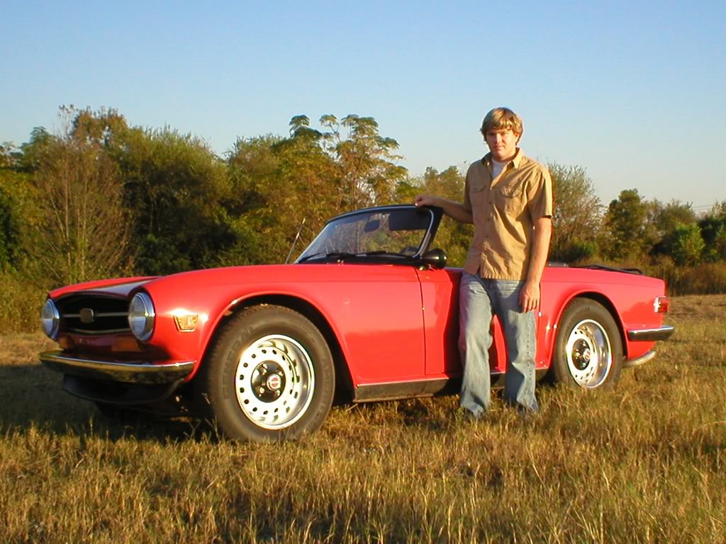

Same color as mine. Check those tires carefully. I replaced mine with Michelins - tubeless - a little over a year ago. No problems, no leaks - and I've got wire wheels. Very carefully check where the rear suspension attaches to the frame. I had one side welded 17 years ago and never a problem. I second the emergency hood cable (really a rod) - in fact, I use it more than the original cable. Make sure the carbs have oil in the dashpots. Though opinions differ, engine oil is usually fine. I use premium gas and have not had a problem with pinging although my timing is a bit advanced for more performance. Try to find out when and if the thrust washers have been replaced. If they have not, one of the mavens on this board will be glad to tell you exactly how to measure it. If they get worn and fall into the crankcase, your engine can be ruined in short order. I replaced mine last summer and one (there are 2 halves) was a bit worn but still in place. make sure you replace them the correct way - I believe one of the manuals shows it backwards. If the valve seats have not been replaced, consider adding some lead additive each time you fill up - although for 16 years I had no trouble with the original seats. Finally, carry at all times a spare fanbelt, some tools, a set of points, coil and condenser (unless you have electronic ignition). Electronic ignition is controversial - some swear by it, others, like me, tried it and then went back to points because it was cutting out in hot weather. Good luck and let us all know how you are doing.
