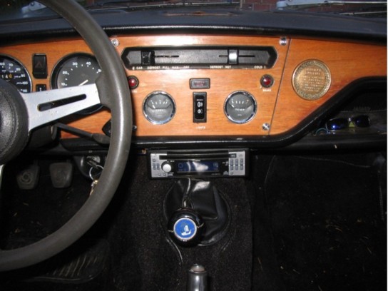

I'm finally done with my dash. Since it's my daily driver I did one section at a time so it took over a month, 7-10 days on each section. The vernier was in good shape but the plywood was delaminated so badly that in places you could see through it looking on edge. I glued and clamped a little section at a time. The finish peeled off with an exacto blade. I gave it a light sanding and 7 coats of Minwax Polyshades Olde Maple Gloss (I used foam brushes) sanding with 600 paper between coats. I'm really happy with the results and I spent less than 15 bucks for finish, brushes and sandpaper.
