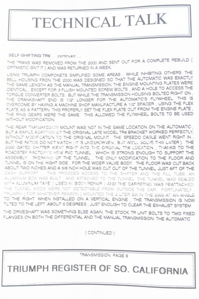

I seem to remember Steve telling me the automatic came straight out of a Triumph 2000 or 2500 sedan.
2000 I believe. He also got the mounting plate and flywheel from the same car. An important part was that the 2000 has the engine canted to the side, so using that mounting plate wound up with the BW35 sump canted the other way, so it would fit between the TR frame rails.
I've got the article that Steve wrote for the local club magazine, describing the conversion. It's somewhere deep in a big pile of documents to scan, but I could move it to the top if someone is interested.

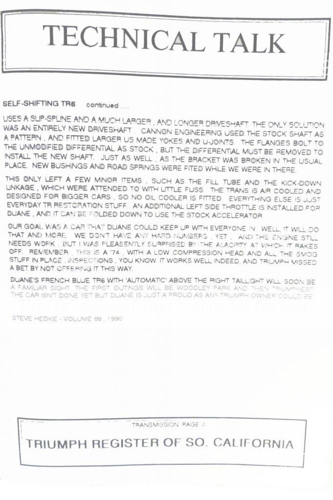

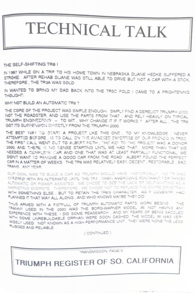

...I've got the article that Steve wrote for the local club magazine, describing the conversion. It's somewhere deep in a big pile of documents to scan, but I could move it to the top if someone is interested.
Mine wasn't buried deep - I have the reprint it in Volume 2 of TRSC's Technical Talk. Here's a quick & dirty copy:
