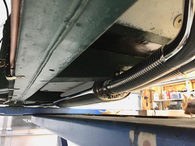

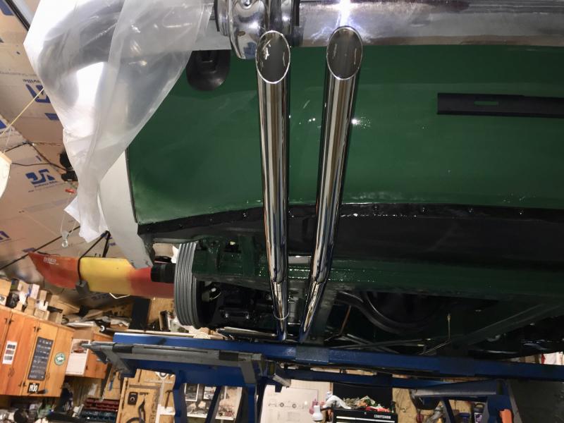

installed the system today. boy that was not the easiest exhaust i ever put on. in fact i think i have had rusty units that went on better. i am guessing the SS piping is a bit thicker and the parts just do not want to go together unless they are really aligned well. also would help to have someone else holding the system. i ended up using a rachet strap to hold it up tight while i tapped and wiggled it up. a couple of pics below. after looking at them i felt like the inside pipe was lower than the outside. both of my back brackets were on the outised pipe. i decided i did not like that so i went back out and adjusted the one right behind the muffler so it was attached to the inside pipe. that helped to pull it straighter and i believe it will hold the system steadier. if i was to make a suggestion to someone, that would be it.
getting that front hanger attached, as far as getting the bolt in, was not that easy either.

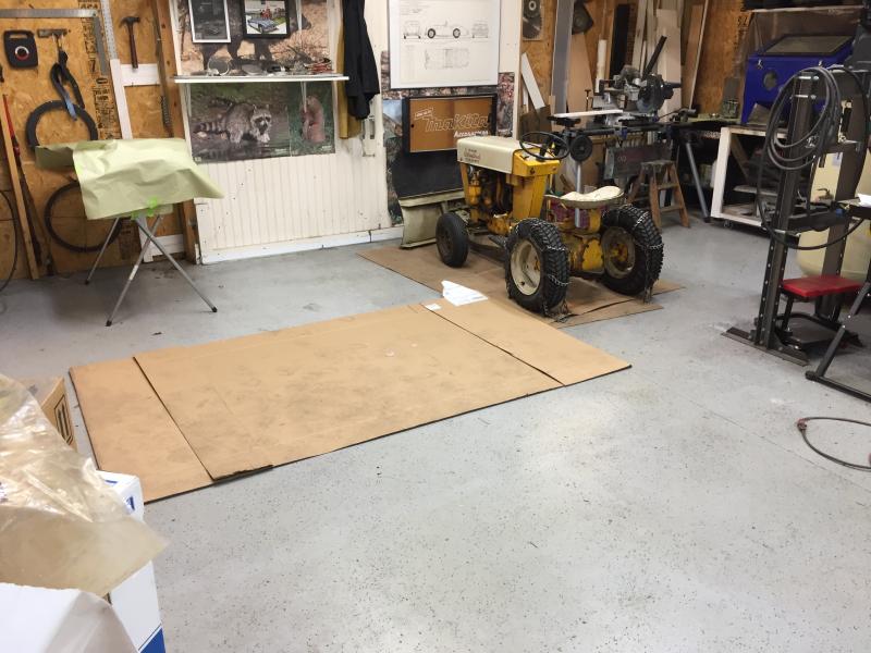

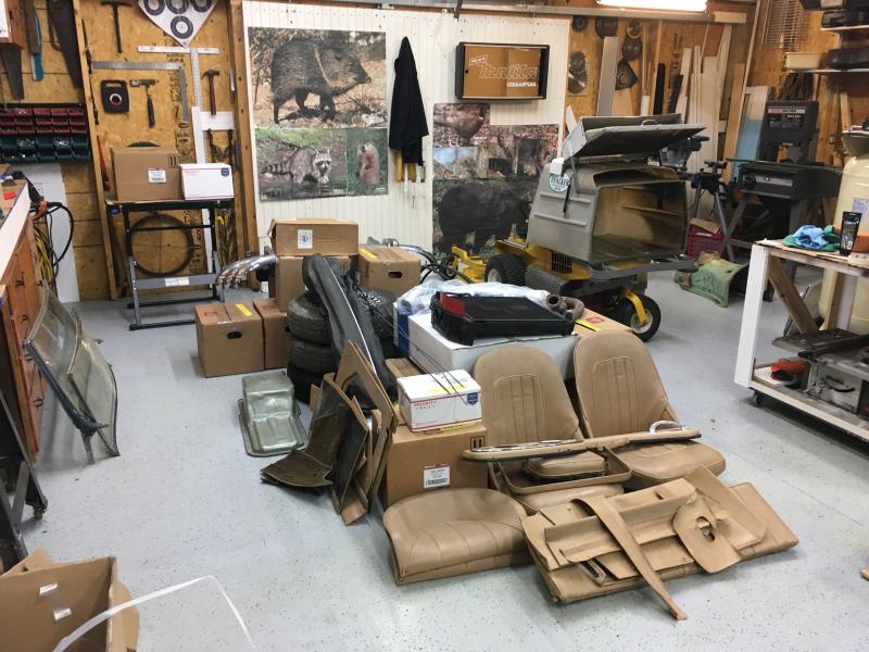

the other nice note is the garage is starting to look like a garage again. two pics... one from last July and one from today.
yes the second one is from today.... sorry got off topic again. but it is nice to have that stuff off the floor.

I've had mine on my car for about 2 years. Looks great ,but I had a lot of leaks at the joints. U bolt clamps tend to deform the thin wall tubing. I purchased SS strap clamps from Moss that solved the problem. I then had to modify some of the hangers that use the U bolt clamps so they no longer performed double duty of holding the pipe joint together and holdinf the exhaust system to the car.
