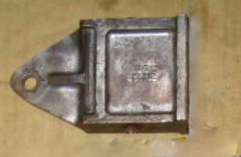

Fitting new lever shocks on my live axle TR4A I find the shock link dangling from the lever arm, and the distance piece broken at the link mounting hole. Looking at the Moss catalog I see that the distance piece (P/N 674-560) is not available.

He's not looking for the link, he needs the aluminum distance piece between the spring and the axle. Mounting location broke.

Is this it? I have had this with parts I got with my TR4A in 1985
It looks similar but not the same as catalog pic
Nope, those distance pieces are for a TR4, the "ear" on the TR4A distance piece is centered.

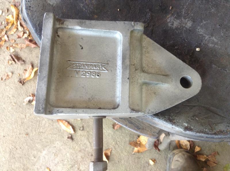

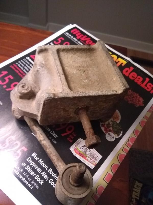

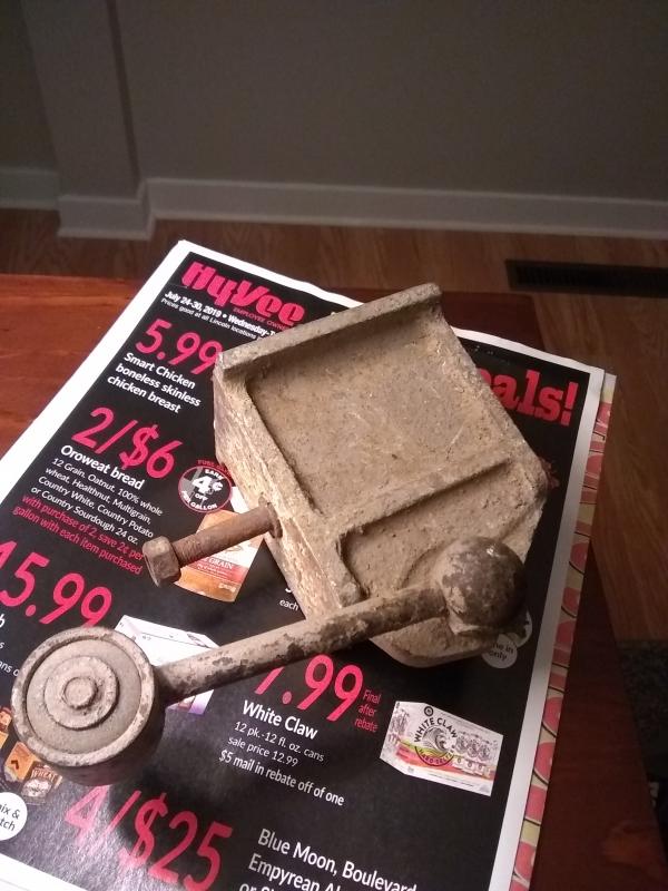

Somebody else can correct me ---but the TR4 does not use that kind of a distance piece. Only the TR4A with the solid axle had those.
TR4s, from CT23383 on, have the distance piece pictured in post #12, there's a LH and a RH.
My '63 TR4 CT246XXLO has them.
All TR4As with a solid rear axle use the distance piece I pictured in post#13, RH/LH are the same.
