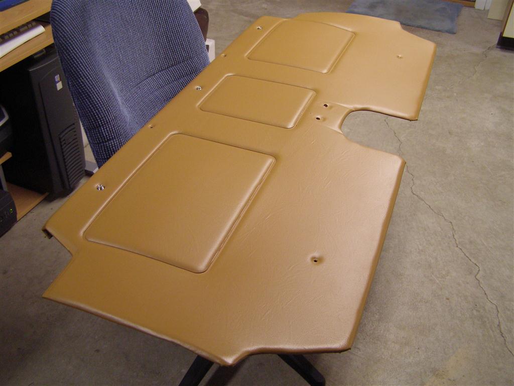

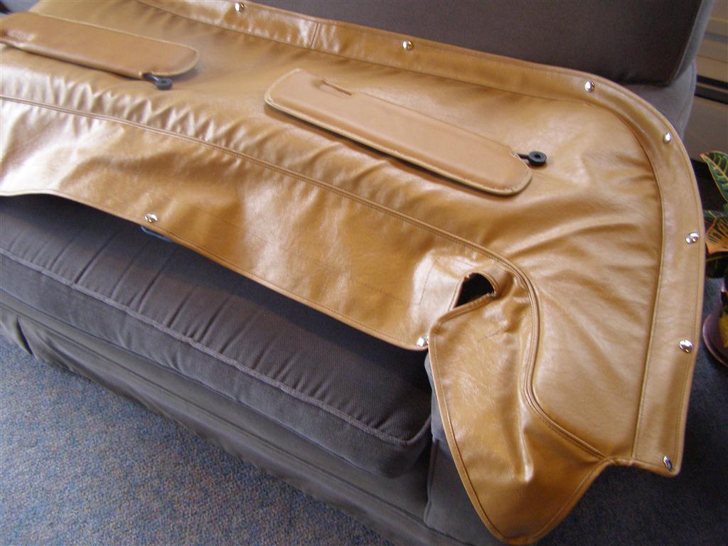

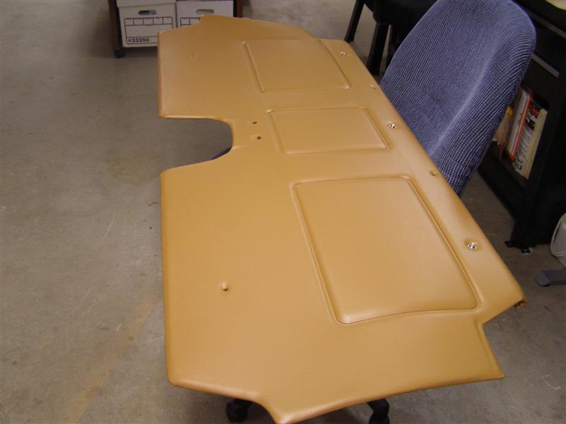

You can also have a flexible paint mixed to dye the boot to match the seats and door trims when you have everything together. The body shop near you that uses DuPont products can have the trim color matched to meet the shade of the Moss trim and have them spray it for you. I did that with the boot and rear panel behind the seats of my TR8, which was sun bleached. They now both match and look great.

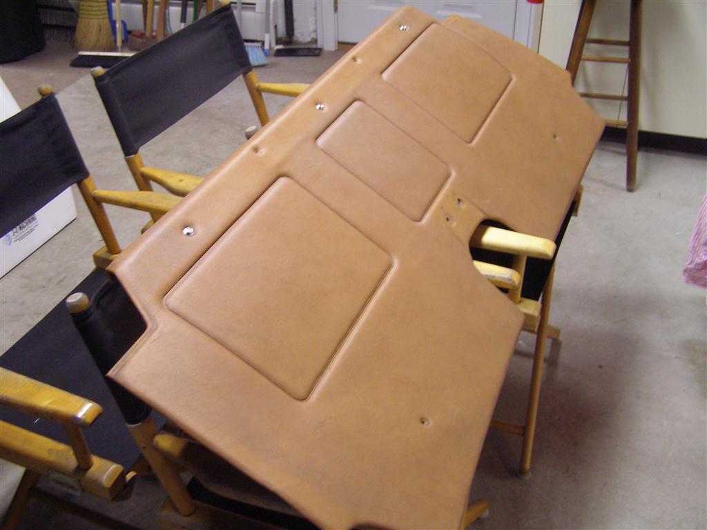

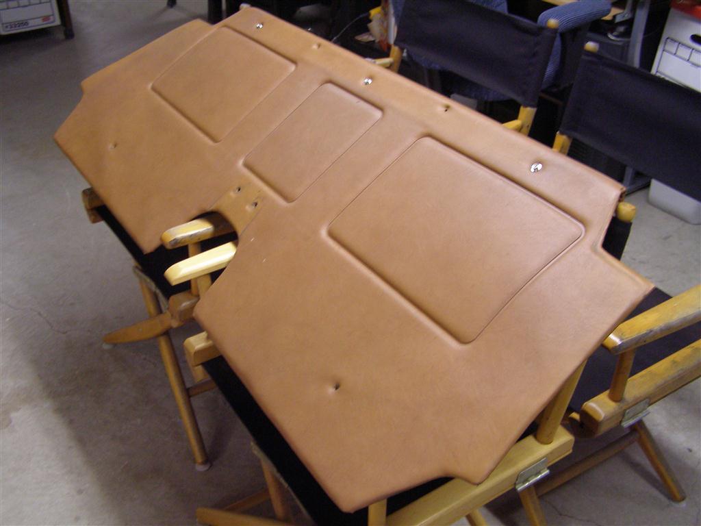

At least you guys know the brand name of the flexible paint that we used. It really works well.

Darrell, it was sprayed on at the body shop, per the instructions on the can. I twisted the boot in every direction possible and then had new snaps installed with no issues, so it is really very flexible paint.
The color was made to match the new material that I received for the visors, which matches the bulk of the material in the car. They tinted by eye, so there is no color formula for these.

One thing to mention. When I got the panels and the boot back from the shop, I let them sit for a week to cure. It may have been overkill, because they were very dry when I picked them up after two days in the paint booth at about 90 degrees, but better safe than sorry.
