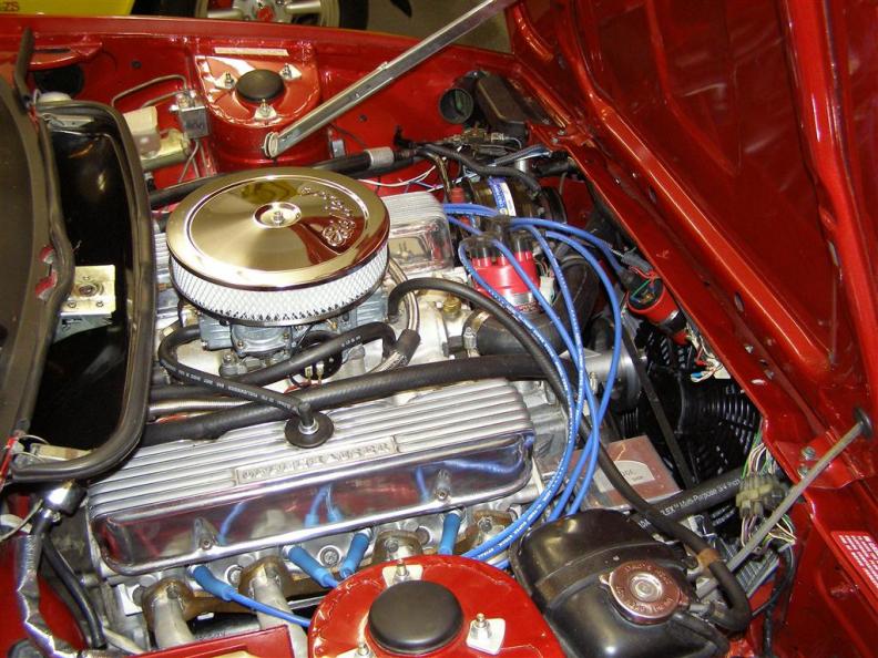

I have removed my A/C condenser and have a new aluminum radiator to go with my new engine. It runs just above the middle on the hottest summer days with the fan on.
EDIT: The fan is setup as a puller.
