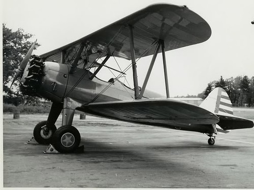

The great benefit of the biplane was that it offered the designer the ability to combine strength with a lot of lift but with a very short wingspan. The two wings of the biplane effectively form a box, which, with struts and bracing wires, can be made to be very strong. But, just as importantly, because all the struts and wires are 'inside' the box they tend to be self compensating - when a force, say lift, acts to tension one set of wires the other set have the strain on them reduced.
Also, (remember that flaps weren't around in the early days) generally speaking biplanes had a lower take-off and landing speed, and per foot of wingspan generated more lift and less drag than an equivalent monoplane design.
Monoplane designs only really began to surpass biplanes when new materials became available to build wings that could be braced internally and the power out put of new engines meant that the drag caused by all the wires and struts of a biplane posed too great a penalty in terms of the aircraft's performance.
My old Stearman shown in the first photo, was a later example of Bi planes, which the military used for trainers due to their ability to take tremendous abuse prior and during WW-II. The Stearman could take 10 Gs of force up or down, yet be gentle to fly! Today Bi planes are still built for aerobatic purposes as they can be made smaller but still remain very strong and they look pretty cool also! PJ
