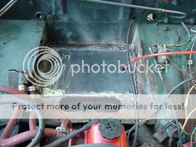

New battery box plate welded in. Nice and thick.

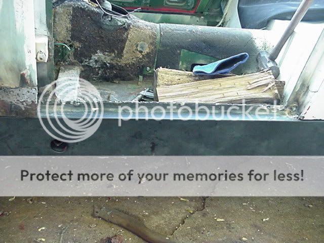

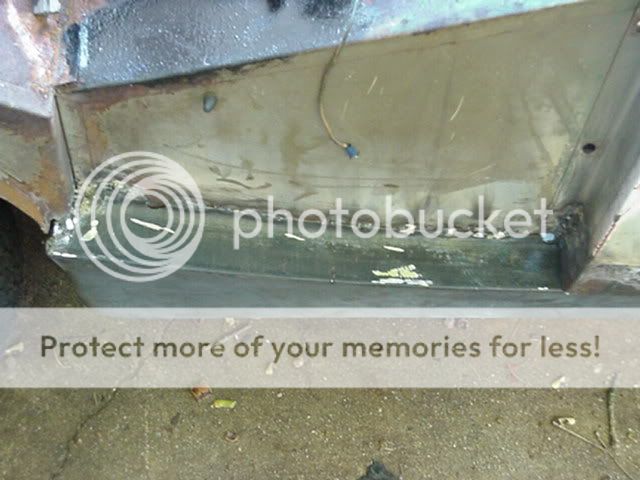

New sill all welded in.

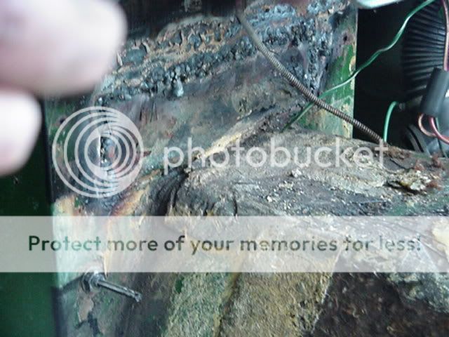

New thick plate in foot floor panel.

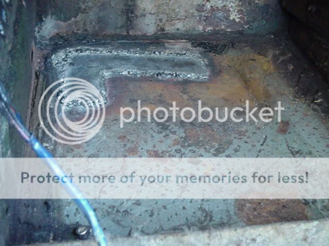

Welded up hole that the "highly intelligent" previous owner butchered out to put in a longer radio. This is the Icky backside of the weld. I welded it through the cut out of the old battery box. Either way it was just hard to get to and trying to fill in a 1/8 gap. One day I will have a TIG welder but not today. It is all filled in though ugly. I will grind that side down before painting.
Your work is great!
Do NOT sell yourself short. Filling a 1/8" gap with TIG won't be any easier or prettier on the backside. There is no cover gas back there and filling large gaps on thin metal with TIG is an art. The flux core and you have done a really nice job!
Enjoy the vacation and be sure to post more pictures after you return.
