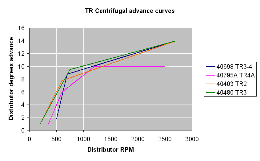

Curious: the chart shows distributor RPM. Is that 1/2 of crank RPM? What is idle on your chart. Le.
The last time I set the timing it seems i had the vernier scale cranked in all the way to one side...
That's a good question. Everything that I've read is that the mechanical advance starts anywhere between 450-800 engine rpm. I'd have to think that that is a misprint on that chart. I've always used the static method followed by road adjustments for ping.
